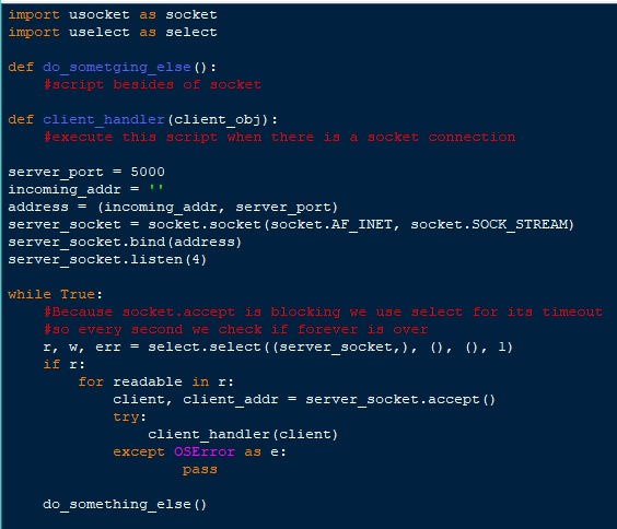

To whom this may concern! This is just an update to the question i asked, particularly how to accept a socket that is blocking, to which recently I found a solution using select and hope this will be beneficial to someone else. Below is the solution
import usocket as socket
import uselect as select
def do_something_else():
#The other script to be executed besides of the blocking socket
def Client_handler(client_obj):
#Do this when there's a socket connection
server = socket.socket(socket.AF_INET
, socket.SOCK_STREAM)
server.bind(('', 5000))
server.listen(5)
r, w, err = select.select((server,), (), (), 1)
if r:
for readable in r:
client, client _addr = server.accept()
try:
Client_handler(client)
except OSError as e:
pass
do_something_else()

Post by worldofchris » Sun Oct 07, 2018 6:08 pm
Thanks zedtech for the above. Exactly what I was looking for and works like a charm.
Re: how can non-blocking socket instances be implemented
Post by pythoncoder » Mon Oct 08, 2018 5:23 am
You might like to look at the docs for uselect for a more efficient approach than using select.select().
