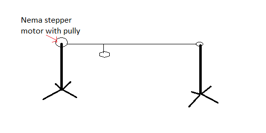

Re: Driver for NEMA 17 stepper motor ?
Then you need to calculate static and dynamic friction of your system. And then whatever acceleration you want to provide to the object.
But 1000 metres?? You've got a bunch of other practical considerations to worry about. Like 1000m of rope probably weighs more than your object!

Hi Jimmo, it will be less then 1000 meters. below is my idea to move the object forward and backward with NEMA stepper motor. Now i am confused with choosing the stepper motor and drivers.jimmo wrote: ↑Fri Jun 28, 2019 9:59 amThen you need to calculate static and dynamic friction of your system. And then whatever acceleration you want to provide to the object.
