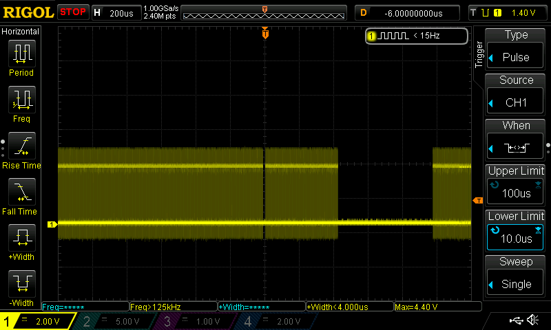

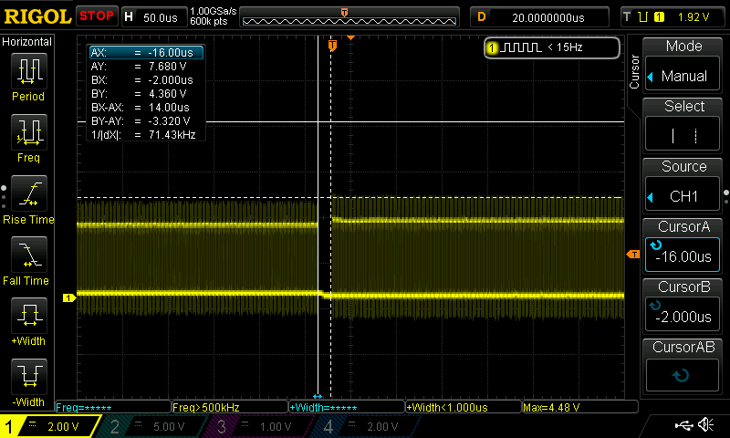

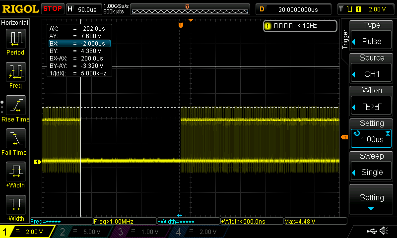

I did some more testing of the Neopixel module. I used the module with the pyBoard before and it was driving my word clock (114 WS2812B LEDs) really stable. Now I moved parts of the code to the ESP8266 and there are some glitches in the signal. My code is calling NeoPixel.write() with constant data in a tight loop. Only a few LEDs are on and most LEDs are off.
Unfortunately, LEDs are flickering. Approximately 10 times per seconds something in the data transmission goes wrong and single LEDs are showing a short flash of wrong color. I used the scope to check the timing, and here are my findings:
Normal pause between complete data packets: around 200 us
Irregular pause inside data packets: around 14 us
Another sample of irregular pause right before the end of the data stream
As seen in the screenshots, some of the data packets are interrupted by short pauses of 14...16 us. As I read, normally 50 us are required to reset the WS2812B and mark the end of a data stream so I wonder if this short pause could be the cause of the flickering LEDs. Can somebody explain these short pauses? Did anybody else run a greater number of WS2812B using the ESP8266?
