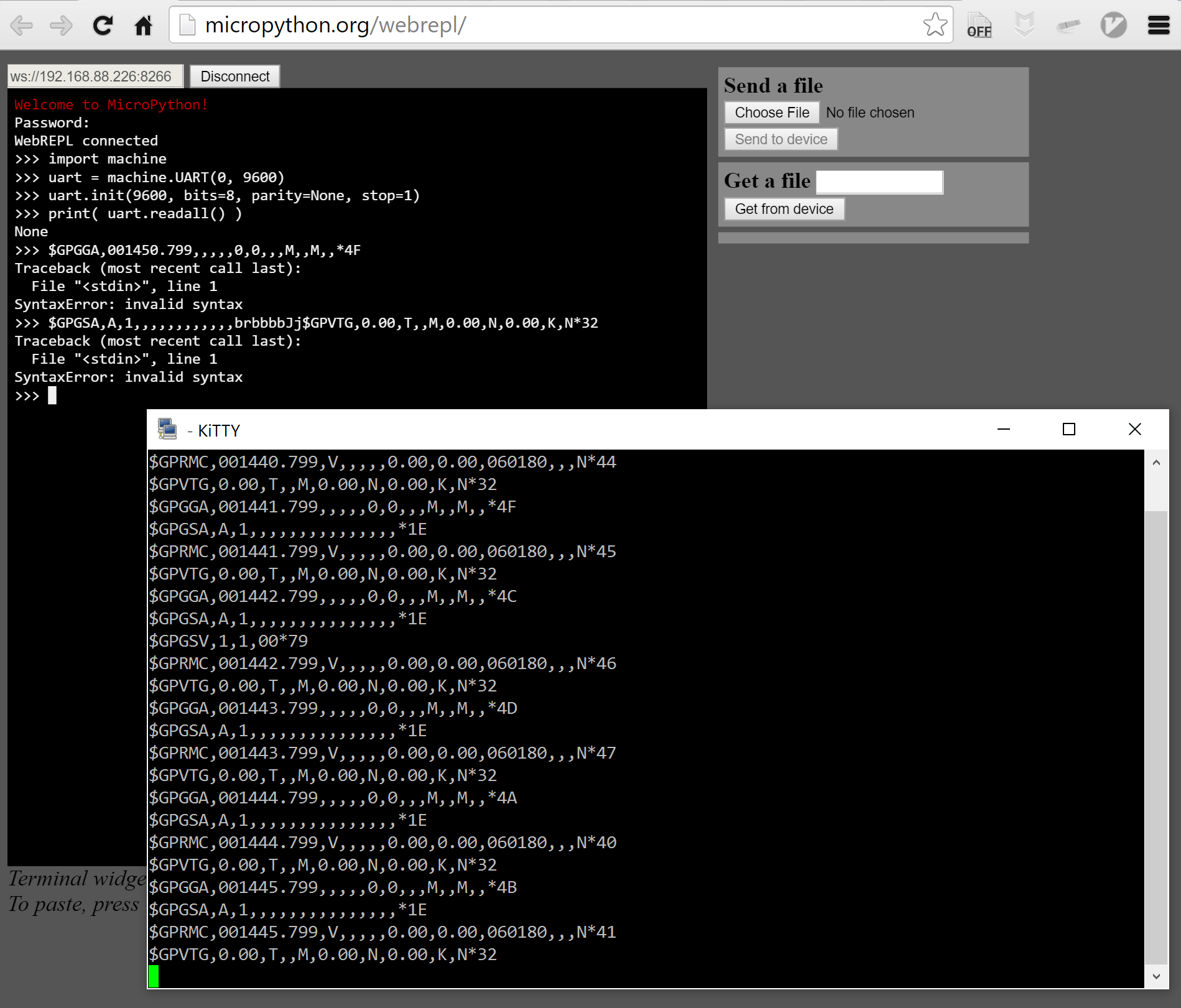

I have Wemos D1 mini board and GPS module. Connected GPS Rx, Tx to Wemos Tx and Rx and trying the MP code from WebRTL
WHAT I TRIED
uart = machine.UART(0, 9600)
print( uart.readall() )
and the result is always None
When I connect GPS module over serial cable I see the output in the terminal on 9600 baud
THE QUESTION
is the MP modules not suitable for this task or I did something wrong?
WHAT I TRIED
THE QUESTION

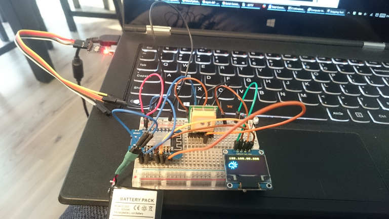

Powered my Wemos d1 mini from external battery. OLED and GPS modules are powered from 3.3V Wemos output. Orange wire goes from gpsTx to espRx.
I took the orange cable out and connected to usb serial - you can see the result output in KiTTy window. New data is comming every second - 1Hz update rate.
When I connected the wire back to espRx, I started to get some data bursts from GPS module. Data is comming in random periods, not every second. And with data the control keys are coming - paste mode is activating and the webrepl is disconnecting.
Why GPS data is not captured to UART buffer? Any thoughts?..

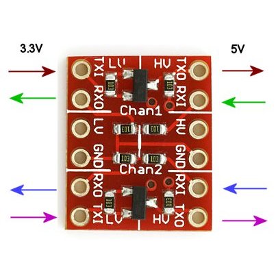

Also, maybe check that your battery is really providing 3.3 V to the ESP and 5.0V to your GPS module, with a multimeter. I can not see clear enough in the image. Does your board already incorporates a logic level converter? If not, you would need to interface both with it:
I had also a problem with not getting back the readings, and it was because my battery was outputing 2.9ish volts. So was not enought for the bluetooth module (or the ESP) but everything seemed ON.
I hope it helps.

@gpson The data looks as if it's terminated with a newline so I'd try the readline() method: this will block until either a line is received or the timeout elapses. Set the timeout to longer than the interval between messages so that in normal operation it won't occur. The issue of control characters is more of a problem: I'd query whether the GPS device should be sending them.
A previous post suggests that the solution to dealing with binary data is to put the device into raw REPL mode. The question is whether there is a way to do this programmatically.

So is this circuit required when the ESP will be listening for a command? I wouldn't think so since it's on the TX line but I want to confirm.
In my case a Pi will send the 's' command to a listening ESP.
Re: So you want to use the UART...
The circuit is to ensure that the logic levels supplied to the ESP8266 don't exceed 3.3V.
