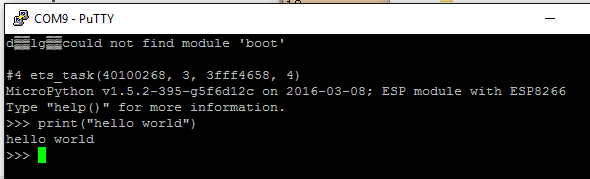

When I connect with putty (using 115200 8/N/1, no parity, no flow control), I get this:
▒▒▒▒"l▒r▒$▒$cl▒▒$n▒p{
                     could not find module 'boot'
#4 ets_task(40100268, 3, 3fff4658, 4)
MicroPython v1.5.2-395-g5f6d12c on 2016-03-08; ESP module with ESP8266
which looks very promising! woohoo!!
