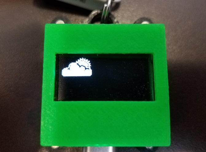

I was able to put two and two together to figure out what you may be looking for.
Based on what I have done for this project https://github.com/joewez/ESP-Widget I use a simple text file that has monochrome bitmap encoded in hex values. For example, the graphic you link might be something like this...
000000008000
0000000CC800
0000000FD800
0000006FFB80
0000007DBF80
0000027EFF30
000003FFF7F0
000003DFFDE0
0001FFFFFFC0
0007FE3FFF78
000FFE3FFFF8
001FFF1FFFB0
001BFF8C7FB8
0037FFC01FFC
003FFFE38730
002FFFE7E7B0
03EFFFFFF3F8
1F8FFFFFF018
3F0FFFFFF018
7FEFFFFFF3DC
FFFFFFFFFFFE
FFFFFFFFEFFE
FFFFFFFFFFFE
FFFFFFFFFFFE
FFFFFFFFFFFE
FFFFFFFFFFFE
FFFFFFFFFFFE
FFFFFFFFFFFE
7FFFFFFFFFFC
3FFFFFFFFFF8
Then I use this simple routine to display the graphic.

There are other methods, so you should search the forum, but if you are starting from where I think you are, this may be helpful.
BTW: I use this http://www.eran.io/the-dot-factory-an-l ... generator/ to convert from the image to text.
Good luck.
