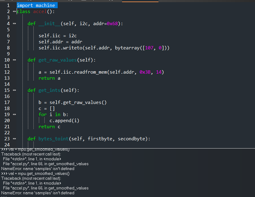

I followed your instruction see below
import machine
class accel():
    def __init__(self, i2c, addr=0x68):
        self.iic = i2c
        self.addr = addr
        self.iic.writeto(self.addr, bytearray([107, 0]))
    def get_raw_values(self):
        a = self.iic.readfrom_mem(self.addr, 0x3B, 14)
        return a
    def get_ints(self):
        b = self.get_raw_values()
        c = []
        for i in b:
            c.append(i)
        return c
    def bytes_toint(self, firstbyte, secondbyte):
        if not firstbyte & 0x80:
            return firstbyte << 8 | secondbyte
        return - (((firstbyte ^ 255) << 8) | (secondbyte ^ 255) + 1)
    def get_values(self):
        raw_ints = self.get_raw_values()
        vals = {}
        vals["AcX"] = self.bytes_toint(raw_ints[0], raw_ints[1])
        vals["AcY"] = self.bytes_toint(raw_ints[2], raw_ints[3])
        vals["AcZ"] = self.bytes_toint(raw_ints[4], raw_ints[5])
        vals["Tmp"] = self.bytes_toint(raw_ints[6], raw_ints[7]) / 340.00 + 36.53
        vals["GyX"] = self.bytes_toint(raw_ints[8], raw_ints[9])
        vals["GyY"] = self.bytes_toint(raw_ints[10], raw_ints[11])
        vals["GyZ"] = self.bytes_toint(raw_ints[12], raw_ints[13])
        return vals  # returned in range of Int16
        # -32768 to 32767
    def get_smoothed_values(self, n_samples=10):
        result = self.get_values()
        for _ in range(0, n_samples - 1):
            data = self.get_values()
            for key in data.keys():
                result[key] += data[key]
            result[key] /= n_samples
        return result
    def calibrate(self, threshold=50, n_samples=100):
        while True:
            v1 = self.get_smoothed_values(n_samples)
            v2 = self.get_smoothed_values(n_samples)
        # Check all consecutive measurements are within
        # the threshold. We use abs() so all calculated
        # differences are positive.
            if all(abs(v1[key] - v2[key]) < threshold for key in v1.keys()):
                return v1  # Calibrated.
    # ONLY FOR TESTING! Also, fast reading sometimes crashes IIC
    def val_test(self):
        from time import sleep
        while 1:
            print(self.get_values())
            sleep(0.05)
samerou
Posts: 38
Joined: Mon Feb 11, 2019 12:51 pm
Re: Gyro/Mpu_Calibration "ESP8266"
Post by samerou » Mon Apr 22, 2019 4:39 pm
@Roberthh , it workedd thank you and the values aren't weird but it need to get more stable

pythoncoder wrote:
Wed Apr 24, 2019 7:16 am
@samerou The "bad chip ID" indicates that your chip is not a genuine InvenSense MPU-6050. This chip has been obsolete for a long time: even the MPU-9150 is obsolete with only the MPU-9250 currently manufactured.
So I would question exactly what hardware you are using. This may be affecting your other results.
If you want to live dangerously you could comment out line 105 in imu.py:
        self.chip_id                     # Test communication by reading chip_id: throws exception on error
This would disable the check. But with an unknown device all bets of decent results are off.
I'm using " MPU6050 - GY521 ACCELEROMETRE ET GYROSCOPE 3 AXES" and UPYcraft as plateform for developpment
