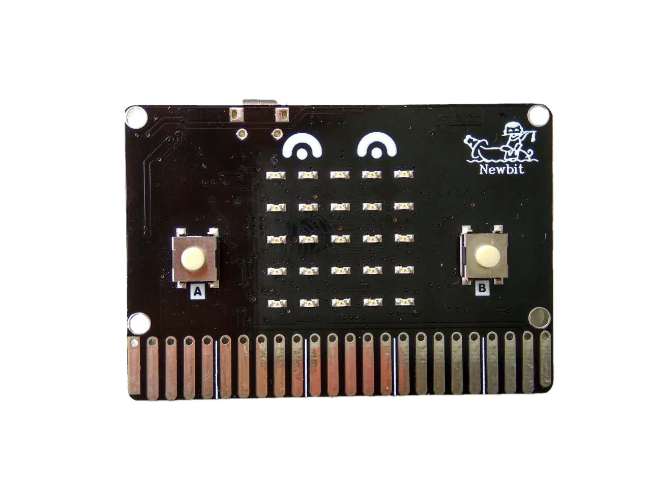

Post by shaoziyang » Tue Mar 28, 2017 5:12 am

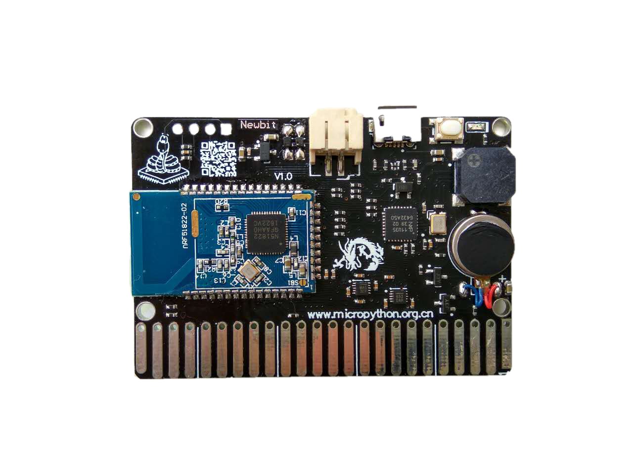

My newbit board, compatible with microbit. I add buzzer, so it may play music directly. And I also add a vibrator, provide feedback in play games.

Post by deshipu » Tue Mar 28, 2017 7:24 am
That looks great. I was thinking about following the reference design myself, but first I'm waiting for the nrf51822 dev board to try flashing MicroPython on it. Did you have any problems with it?

Post by shaoziyang » Tue Mar 28, 2017 7:50 am
It works fine, I have test it in micropython, python Editor, javascript block editor.
You may using IOS app to download with bluetooth , but android app always fail.

Post by shaoziyang » Tue Mar 28, 2017 7:52 am
deshipu wrote:That looks great. I was thinking about following the reference design myself, but first I'm waiting for the nrf51822 dev board to try flashing MicroPython on it. Did you have any problems with it?
The problem in microbit is micropython version is too old, and paste mode is not work. And free space in flash is only 8KB.

Post by shaoziyang » Tue Mar 28, 2017 11:59 am
fizban wrote:Interesting. I see the micropython.cn community is comercializing it already for 100 Yuans in taobao, which might be around 13,5 euro...
Yes, I made 100 pieces newbit board last week, only 100 yuan cost price, in order to let more people in Chinese micropython communit may try it.

Smallest Chinese fonts is 12x11 matrix, it need more space to place LEDs, and will not compatibity with microbit code. I consider add a 128x64 OLED module, include a font chip, using SPI bus.
