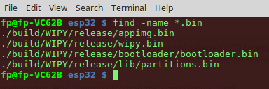

@Roberthh Hi, I guess you have a lot of experience with PYCOM implementation of MP. It would be nice if you could help me with some good advice as last time. I am trying to build own image for Wipy 2 and I have to flash binaries on another machine.
I have found these binaries after build... see the picture.
BUT I can not find information where to burn it (on which addresses).
Will be there someone who will help me with the right info?
Re: Tool uPyLoader for MP on esp32
Post by Roberthh » Fri Nov 10, 2017 12:06 pm
Hello @profra, I responded already to your question in the pycom.io board. The answer can be found in the makefile applicatio.mk, which also controls flashing:
BOOT_OFFSET = 0x1000
PART_OFFSET = 0x8000
APP_OFFSET = 0x10000
You do not need to flash wipy.bin. If you want to see, how the call fopr esptool.py should look like, simply rund on rou build machine the command:
make V=1 BOARD=WIPY flash
Even if that dos not succeed, you see the call for esptool.py and its parameters, which you then can take to the other machine.
