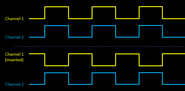

@laboris Would it be possible to add a feature so you could programmatically invert or offset the duty cycle of some of the channels on a timer?
PWM inverted.png (4.61 KiB) Viewed 12084 times
loboris
Posts: 344
Joined: Fri Oct 02, 2015 6:19 pm
Re: ESP32 maximum PWM frequency
Post by loboris » Tue Jan 30, 2018 7:34 pm
rdagger wrote:
Tue Jan 30, 2018 6:39 pm
@laboris Would it be possible to add a feature so you could programmatically invert or offset the duty cycle of some of the channels on a timer?PWM inverted.png
All PWM channels using the same timer have the same frequency and phase.
PWM channel started with different timer will have some random offset depending on time when the timer was started.
It could be possible to synchronize two PWMs, each using a different timer, in such way that one is started at the known time after the other.
That time would be the phase offset between channels.
If that time is half the timer period and the channels period and duty cycles are the same, the PWM's outputs would be inverted.
I'll test it and add that option if it works as expected.
