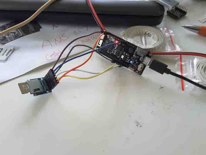

Some updates on this. I am still unable to access the sd card so I will give more explanation about what I have done so far, hoping someone will find the explanation. I have run the following commands on my host computer :
./BUILD.sh menuconfig
# change sd setting to 1-line
./BUILD.sh
./BUILD.sh flash
./BUILD.sh monitor
My circuit is currently looking like that :
higher resolution
higher resolution
I believe I followed all the explanations from the wiki now that the pullup resistors have been added. I have tried two different card adapters and two different microSd cards (1x philips; 1x SanDisk).
Thanks in advance for any pointer.

Post by liudr » Fri Mar 23, 2018 5:49 am
I believe that I have the same sd card adapter and it didn't work. I tried to supply it 5V and 3.3 and pullup/no pullup (the module seems to have 4 pullup resistors on board). Killed a card in the process (reversed power pins). I gave up. I took an sd-microsd adapter and soldered pins to it. Finally I got it to work after making some mistakes. My mistake was using the wrong pin for CS. My dev board's pin markings confused me.
So for you, can I recommend using 5V on the sd card adapter's VCC since it needs 5V to generate 3.3V with its on board regulator? Be careful though, use a cheap low-capacity card.

Post by liudr » Fri Mar 23, 2018 7:59 pm
Soldered pins to an sd-microsd card adapter and added 10K pullup resistors:
Works like a charm! :lol: The pads are exactly 0.1 inches apart so all I did was lining up the pins and the pads and solder. I then removed the plastic spacer from the pins so I could plug it into a breadboard.
