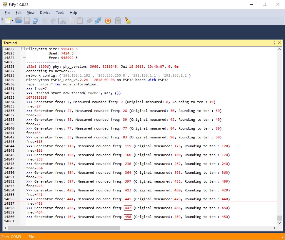

I have same problem. Today i made this code, and it works fine for frequencies under 450Hz (if i understand all right - tachosignal must be less than 150Hz):
def msr():
    global freq
    old_freq = ''
        if freq != old_freq:
            pwm = PWM(Pin(12), freq=freq, duty=50, timer=3)
            measure = Pin(14, Pin.IN, Pin.PULL_DOWN)
            frequency, count = 0, 0
            old_value = 0
            while count < 1000:
                measurement = measure.value()
                if measurement:
                    if not old_value:
                        frequency += 1
                        old_value = measurement
                    elif old_value:
                utime.sleep_us(1000)
                count += 1
            freq_rounded1 = round(frequency*0.92/10)*10
            freq_rounded2 = round(frequency*0.92)
            pwm.deinit()
            print('Generator freq: {0}, Measured rounded freq: {1} (Original measured: {3}, Rounding to ten : {2})'.format(pwm.freq(), freq_rounded2, freq_rounded1, frequency))
        old_freq = freq
        utime.sleep(1)

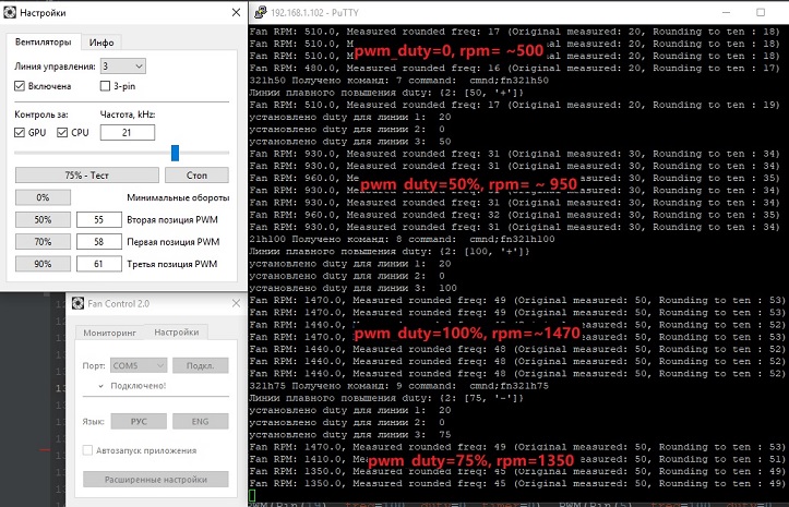

the result of it you can see on picture (RPM measurements for Deepcool UF120, witch have 500/1500rpm min/max in pasport, so, its seems to work well).
but i don't mind to find a better solution.
