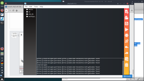

hello dear experts
i ve installed it on Win seven - and get back this
not open port 'None': FileNotFoundError(2, 'Das System kann die angegebene Datei nicht finden.', None, 2)
current version only open py txt json ini file.
could not open port 'None': FileNotFoundError(2, 'Das System kann die angegebene Datei nicht finden.', None, 2)
serial not open
could not open port 'COM3': OSError(22, 'Falscher Parameter.', None, 87)
serial not open

I do not have Ubuntu here - but i have a MX-Linux here. But as i want to install uPyCraft on the Mx-System i guess that i can use the above mentioned commands too. Since Ubuntu relies on Debian and MX does too. This is all the reason for this above mentioned thread!
i sometimes make sure myself in something while writing things down. And in this case i just wanted to ask you - if you can confirm the idea - that Since Ubuntu relies on Debian and MX does too - i would have no issues to install the above mentioned ide on the MX18.03
