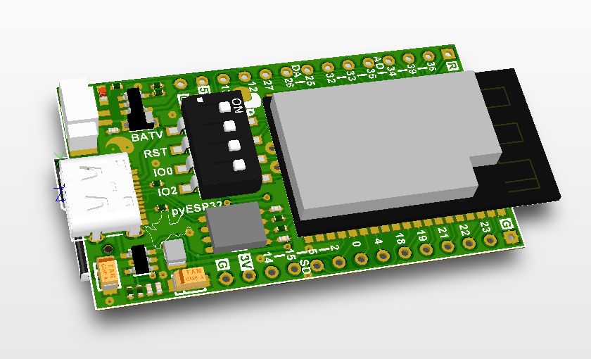

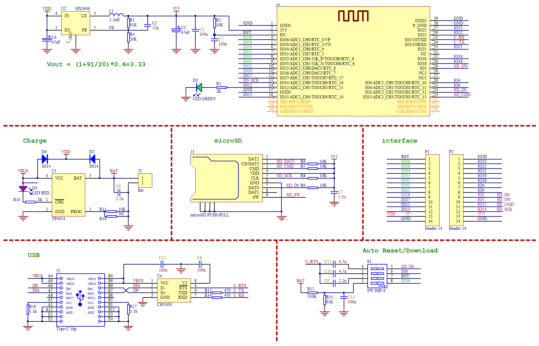

I have design a new small ESP32 board (pyESP32),
main feather:
  • USB type-c interface
  • USB power and charge
  • High efficiency DC/DC power supply
  • on board USB/TTL converter
  • one click upgrade firmware
  • microSD slot
  • low cost
  • open hardware

Nice,
Could you give some more details ?
What is the swiches for?
Does they allow to switch of the USB/TTL device to save power when not in use ?
It would be a nice feature according to me.

I use switch to auto upgrade firmware instead of button, not for switch of the USB/TTL signal. USB device in poweroff mode when USB line is not plugins.
I can't do a complete verification now for some reason, but I do some tests and believe it can work normally. I will share files in github next week.

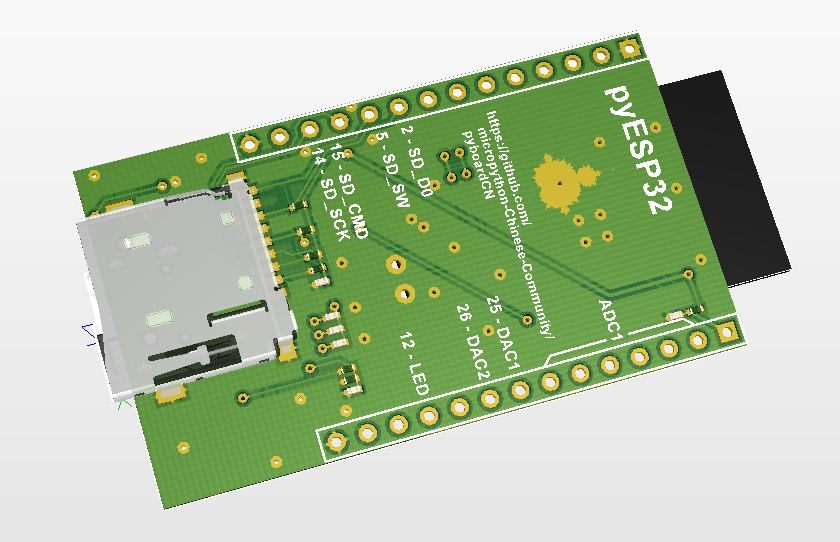

I have share design file in github.
https://github.com/micropython-Chinese- ... ster/ESP32
