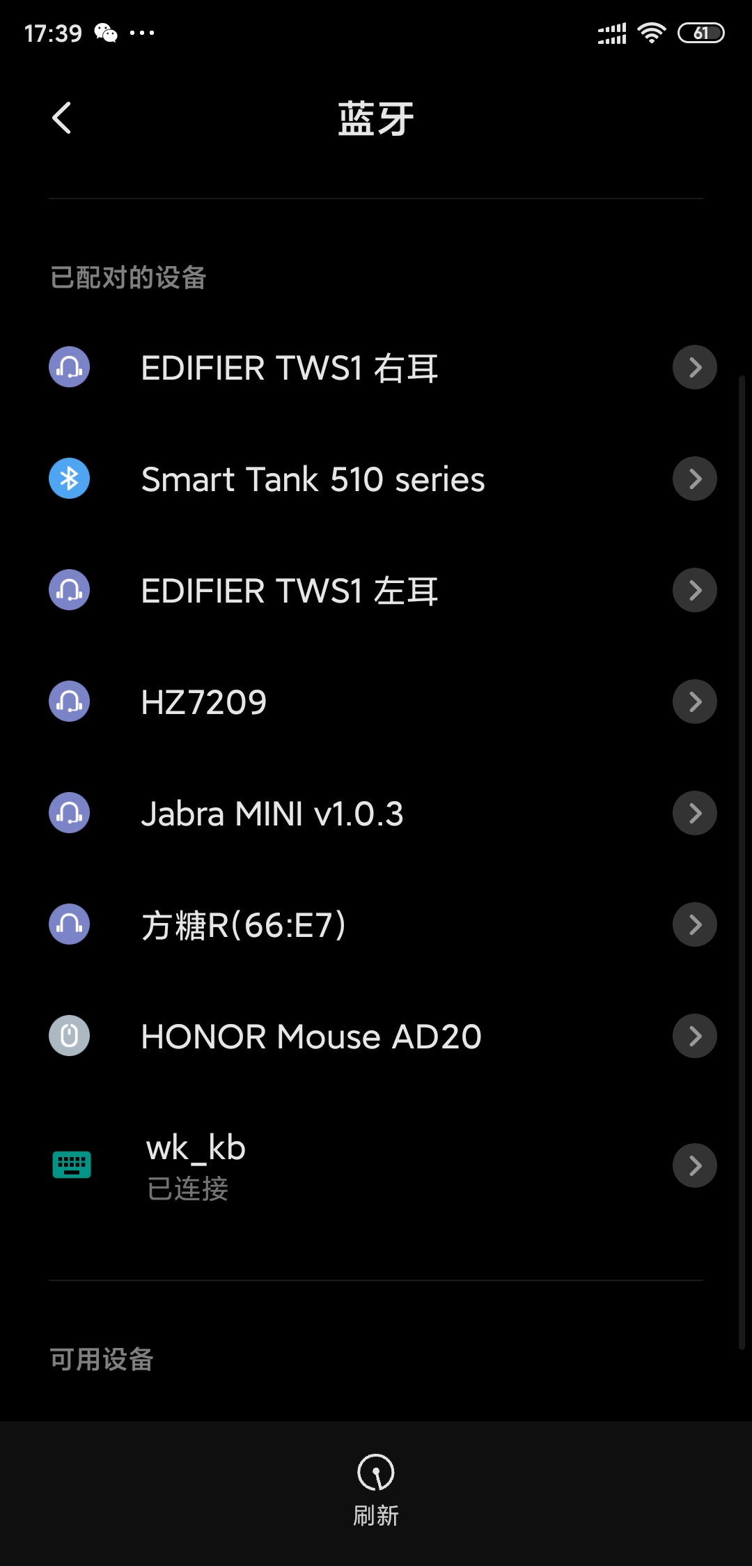

Finally, my device can be bound to the host as a HID device and stay connected.
Last item "wk_kb" status "已连接" means connected.
