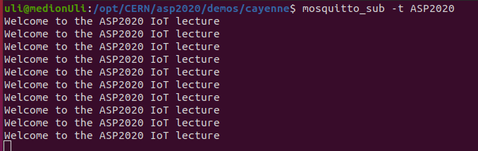

I don't know what you want to use MQTT for but the umqtt module in micropython-lib does the job.
Here is a small example I wrote as a demo for a presentation on IoT.
The connect() function from the module wifi_connect just connects to my WiFi network. I started mosquitto on my Linux PC as well as the mosquitto_sub client subscribing to the ASP2020 (African School of Physics) topic.
