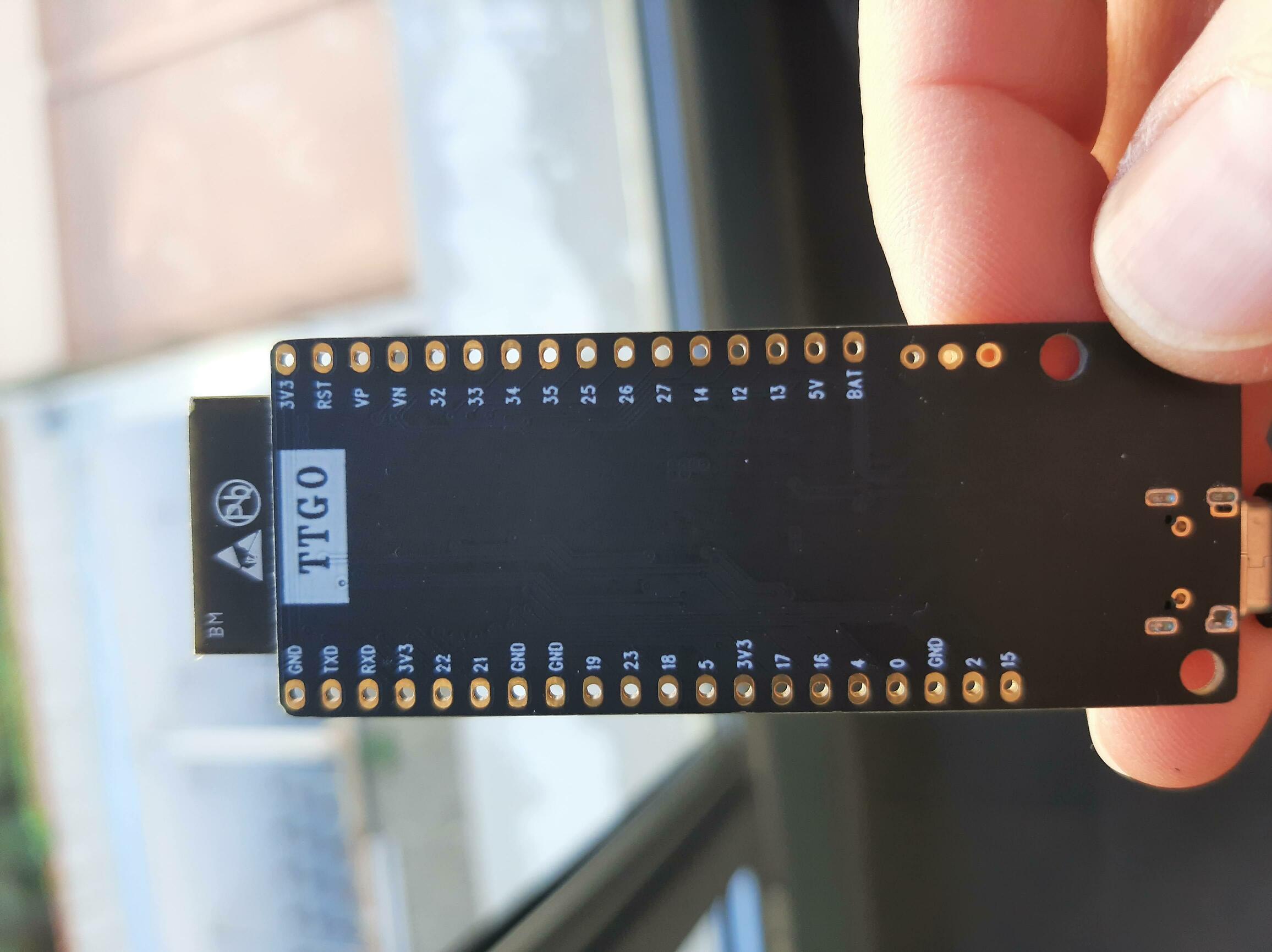

What ESP32 board do you have?
kr-g
Posts: 48
Joined: Sun Dec 01, 2019 7:52 pm
Re: esp32 not responsing
Post by kr-g » Sun Nov 29, 2020 7:38 pm
here some pic's
kr-g
Posts: 48
Post by kr-g » Sun Nov 29, 2020 7:39 pm
frankly - what's the official name - no idea
Post by Roberthh » Sun Nov 29, 2020 8:05 pm
It seems to be a LilyGO T-Koala.
https://github.com/LilyGO/T-Koala and
http://myosuploads3.banggood.com/produc ... TYPE-C.pdf
So you tell that it worked once but no more, and esptool fails. Does esptool work, if you set the device manually to boot mode byte connection GPIO0 to GND and pushing reset?
