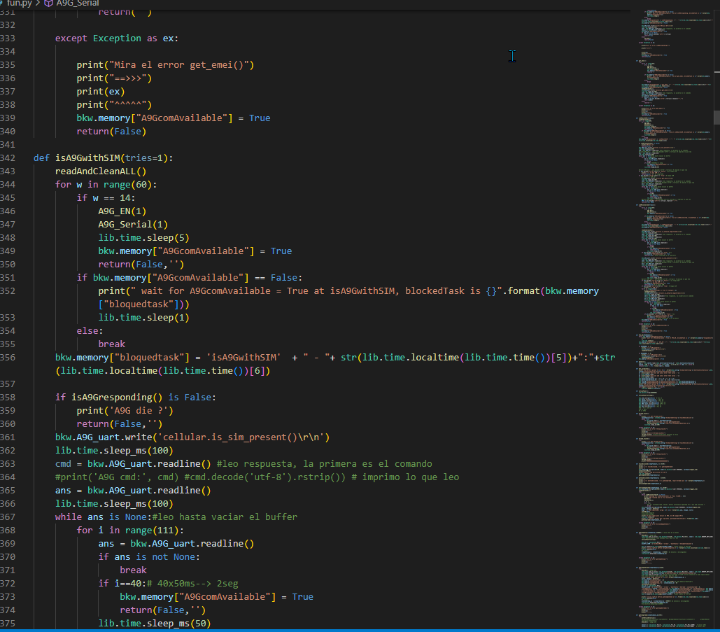

the project I'm working on for months, also you helped me with the first uasyncio demo code in an mp message, which is related to an esp32 talking with an A9G ( btw module is also running mpy, but AT could be the same) wherein the main thread I often query that module via ESP32 UART 2 and sometimes I have to wait for responses due to those serial related time outs ( like bkw.A9G_uart.init(115200,rx=rx, tx=tx, bits=8, parity=None, stop=1, timeout=1000) )
I could bring down that UART timeout lets say to 100ms, and change all individually current functions not using uasyncio to use it so I will not have any time.sleep() waits. I will think in that, I would need to rewrite all to get all time.sleep and time.sleep_ms out.
