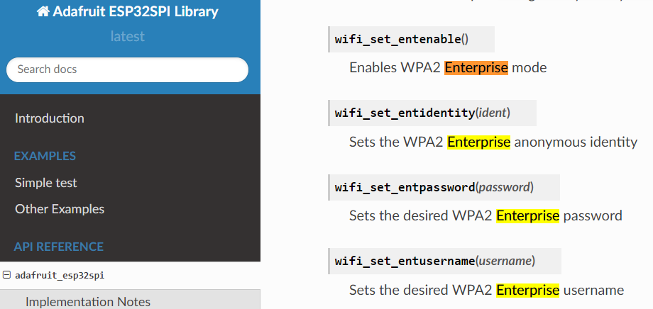

We have a project in development that is now required to have WPA2-Enterprise encryption.
I see the Arduino, Pycom and CircuitPython have this ability.
Has anyone ever seen a library available for micropython?
This is required for most commercial networks and I would hope that micropython would including this connectivity.
2020-10-07 16_01_50-adafruit_esp32spi — Adafruit ESP32SPI Library 1.0 documentation.png
2020-10-07 16_01_50-adafruit_esp32spi — Adafruit ESP32SPI Library 1.0 documentation.png (47.35 KiB) Viewed 9307 times
