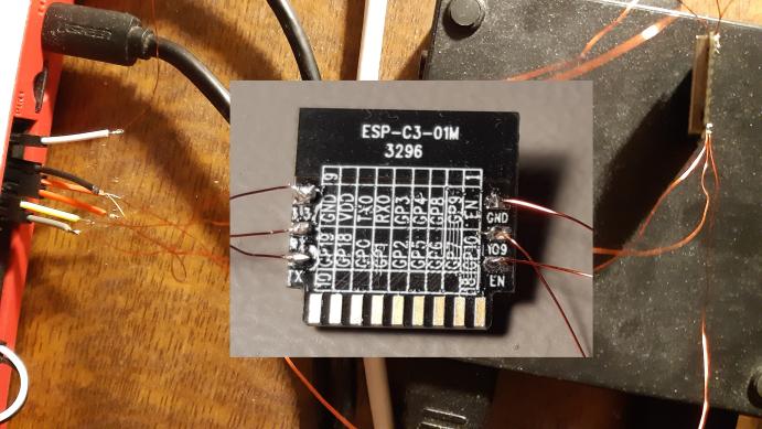

Today I did the same with ESP32-C3-01M, dremeled down from 18×18mm to 18×15.8mm (0.25mm on antenna side, the remainder on contact side):
All started last night by soldering 3.3/RX/TX and GND/I09/EN pins. I only need the TX/RX pins once for flashing MicroPython onto the module, start a MicroPython session and do "import webrepl_setup" to enable Webrepl. Form that time on I use I06/I09/I20(RX)/I21(TX) to control two micro motors via DRV8833 motor controller [that DRV8833 module is dremeled as well :) ]:

Since that point in time, I only connect 3.3/GND/EN pins of ESP-C3-01M with 3V3/GND/3V3 pins of Pi400.

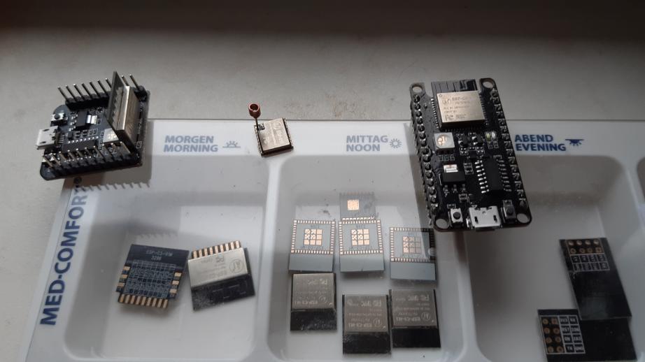

In different thread "Dremel 18×18mm ESP32-C3-01M down to 18×15.8mm fully functional" ESP_Sprite proposed to use ESP32-C3-M1 instead because of its size (16.6×13.2mm):
https://esp32.com/viewtopic.php?f=12&t=25219#p89364
I answered that I have those modules already (in middle box), but that the pin spacing of that module is even less than the 1.1mm of ESP-01F ...

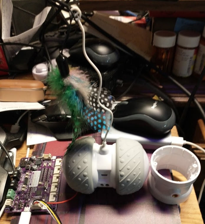

Edit: I noticed you were using TX and RX so after sending an Arduino program to the device, I moved over to the TX and RX pins, and upon resetting it, there it was. I did have to move the Serial Port which changed from plugged into the device USB to running thru a USB adapter to the TX and RX pins. I like your little robots, there was one for about $20 at EBay, that was a cat toy, this board will fit above the existing one and splice into the motor control chips the web page control will have a slider for left to right and another slider for stop to full speed.
