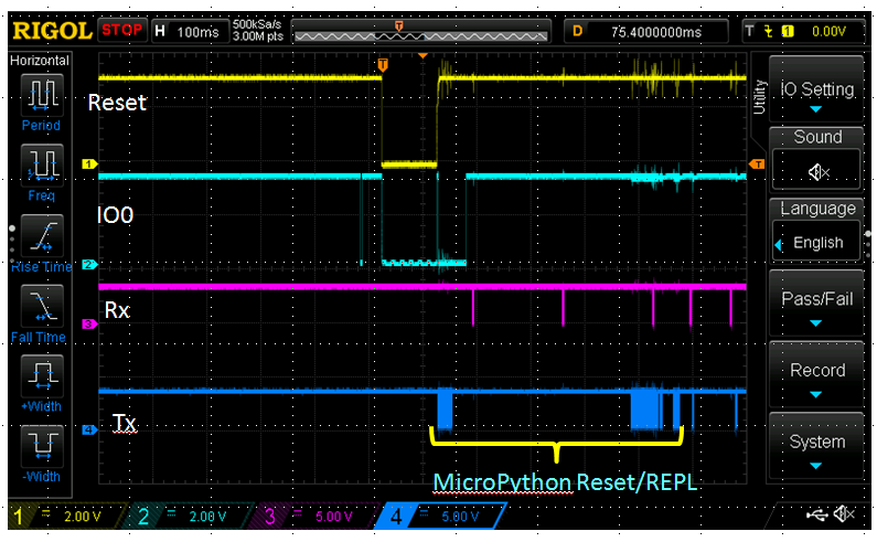

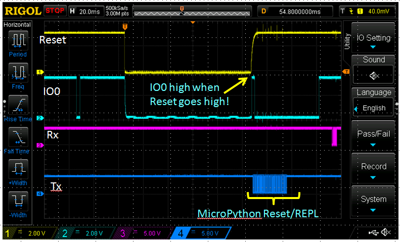

I scoped out the signals and observed very strange transitions on the Reset and GPIO0 pins, shown in the next two images. These scope captures reveal a showstopper problem in the boards shipped to me: GPIO0 is HIGH when Reset transitions to High. ESP32 devices will only enter the bootloader when GPIO0 is LOW when Reset goes High. This signal behaviour results in the ESP32 device resetting rather than entering the bootloader. I used the scope's RS232 decode feature to confirm this - I see the MicroPython REPL prompt rather than the bootloader message. The esptool needs the ESP32 to enter the bootloader for commands to work. Neither of these boards will enter the serial bootloader using the esptool.
Using the same setup, I used the esptool to read the chip_id from a WEMOS D1 mini, an ESP8266 device. This device entered the bootloader, with the captured traces showing the expected behaviour. The chip_id was returned by esptool. Here are the WEMOS D1 Mini signals.
Both the new Lolin branded boards and the Wemos D1 mini use the CH340 USB to Serial device. The Wemos D1 mini worked with the esptool, so my CH340 driver installation on windows would appear to be OK. Looking at the schematics, all 3 boards show the same autoreset circuitry, using RTS and DTR. Perhaps the Lolin board layouts were done incorrectly, or maybe they have incorrectly placed components?

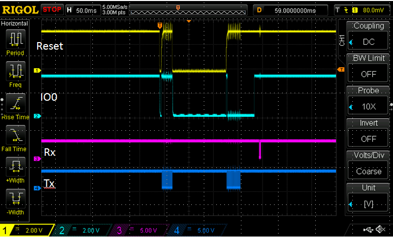

Here are the before and after oscilloscope captures, using esptool to read the flash_id.
BEFORE: no modifications
The ESP32 does not enter the bootloader. Instead it boots from SPI flash.

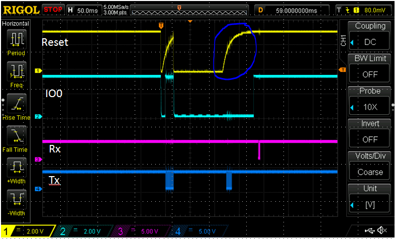

AFTER: 1uF external capacitor added between Reset (labelled RS or RST on the boards) and Ground (labelled GND on the boards)
With the added capacitance, the esptool can place the ESP32 into the bootloader state, and run the flash_id command (WooHoo!)
Why does this fix the problem? I think the root cause of the problem is an undersized Reset capacitor. The schematic for both the Lolin D32 boards show a 100nF (0.1uF) capacitor to ground and a 10k resistor to 3.3v. It appears that the Reset signal rises too quickly with a 100nF capacitor, with the ESP32 detecting IO0 in the HIGH state. In this condition, the ESP32 will boot from SPI flash rather than enter the bootloader. The measured Reset rise time is approximately 4 ms. With the addition of 1uF capacitance, the Reset rise time increases to about 30 ms, highlighted with blue in the AFTER scope capture. You can see that IO0 will be sampled as Low, triggering the ESP32 to enter the bootloader.
