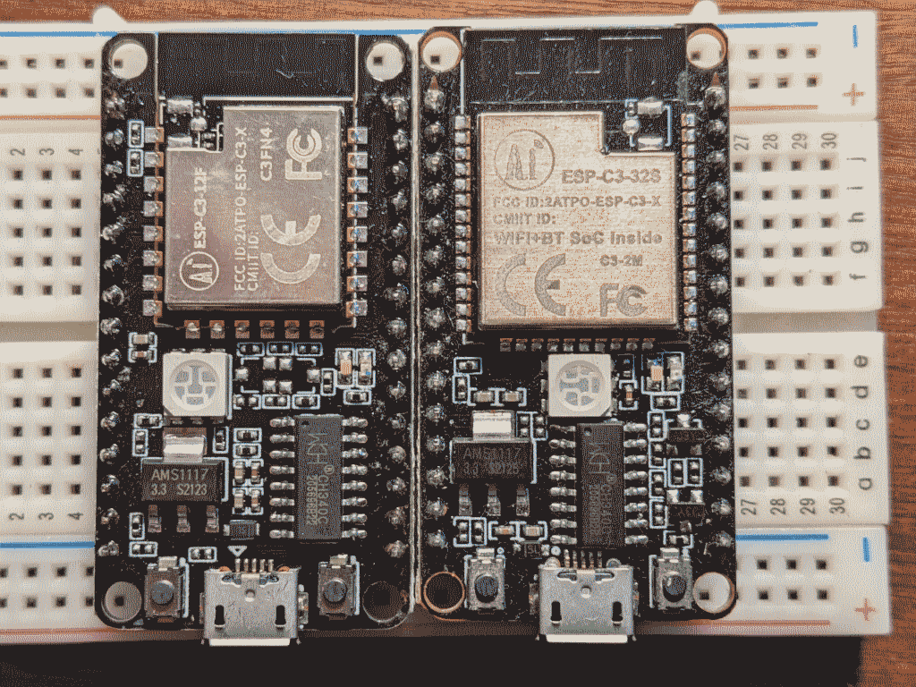

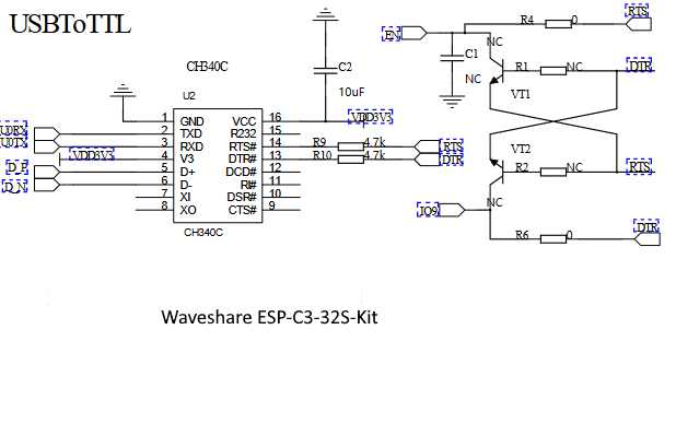

When comparing the schematic diagrams of the two C3 boards, I discovered that 2 NPN transistors for a FlipFlop were left out of the ESP-C3-12F kit. On the photos I took, you can see the missing of the 2 transistors. On the Waveshare ESP-C3-32S-Kit, these NPN transistors were soldered in.
DTR-RTS Flipflop Ai-Thinker ESP-C3-12F-Kit.png (41.37 KiB) Viewed 15211 times
https://docs.ai-thinker.com/_media/esp3 ... cation.pdf
DTR-RTS Flipflop Waveshare ESP-C3-32S-Kit.png (13.37 KiB) Viewed 15211 times
https://www.waveshare.com/w/upload/4/46 ... matics.pdf
ESP-C3 kits top.png (261.73 KiB) Viewed 15211 times
ESP-C3 kits bottom.png (223.05 KiB) Viewed 15211 times
My guess is that because the flipflop is missing, this board can be reset by DTR/RTS or by pushbutton, or put into DFU mode, but the UART is no longer allowed to use DTR/RTS.
