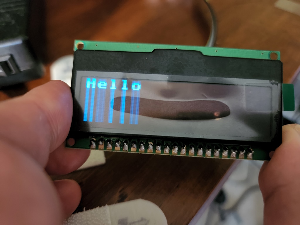

I'm trying an SSD1305 chip display from adafruit with the ssd1306 driver:
Display:
https://www.adafruit.com/product/4567
Code I was using was based on this reference on ESP8266 and I modified it to work, sort of:
https://docs.micropython.org/en/latest/ ... 306-driver
Snippet:
import ssd1306
i2c=I2C(0,sda=Pin(22),scl=Pin(19),freq=100000)
i2c.scan()
display = ssd1306.SSD1306_I2C(128, 64, i2c)
display.rotate(False)
display.text('Hello, World!', 0, 0, 1)
display.text('Hello, World!', 0, 12, 1)
display.text('Hello, World!', 0, 24, 1)
display.show()
I copied ssd1306.py from here:
https://github.com/micropython/micropyt ... ssd1306.py
This youtube video claimed it worked:
https://www.youtube.com/watch?v=KChW4qvw33o
What I got was a lot of ghosting across the vertical dimension of the display. I wonder if it's the display unit that is defective or not. I also have to disable rotate and pretend it were 64 pixels tall although it's only 32 pixels tall.
I'm wondering if this driver isn't compatible, i.e. ssd1306 driver on ssd1305 chipset.

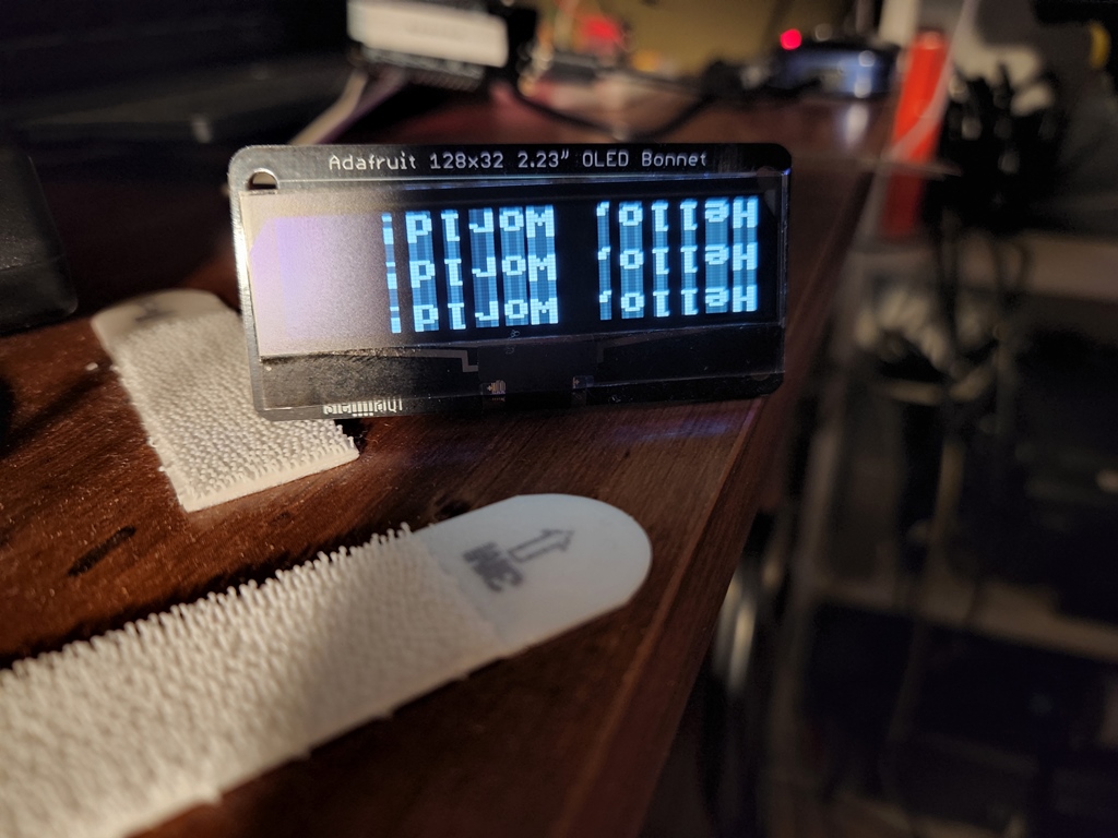

So here is another SSD1305 display I was running SPI on. You can see the streaks run all the way across the vertical dimension from the characters to the bottom.
20220519_112931 (2).jpg (168.41 KiB) Viewed 9149 times
liudr
Posts: 211
Joined: Tue Oct 17, 2017 5:18 am
Re: Trying SSD1305 display from adafruit
Post by liudr » Fri May 20, 2022 3:29 am
Seems to be driver issue. I tested with Arduino IDE and adafruit libraries and the display worked fine. I wish we could get an SSD1305 driver for mp. You can do many project if you have a display.
