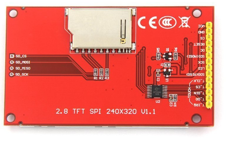

First, I am not sure of the correct wiring for the touch panel. On the back of the display module, the first 5 pins are dedicated to the touch functions:
How should these connect to the ESP32?
I have tried several ways of connecting it, but also due to the second point below, I am not sure whether I got the right wiring, and the wrong test routine, or the other way around, or both.

Ar you sure that a touch sensor is present. The chip U2 seems missing. And if yes, which touch controller should be there?
Edit: On some other pictures I see a XPT2048 populated at that place.

Most likely it is missing.

Wow. Missing chip indeed.
Thanks for pointing that out as I would have never figured it out.
