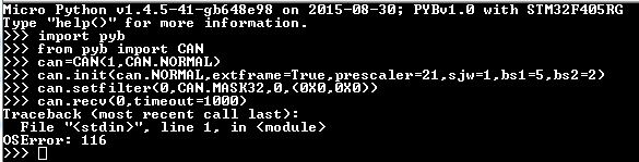

I tried your suggestions. See the attachment. I am getting an OS error 116.
http://www.waveshare.com/sn65hvd230-can-board.htm
I am using this board for connection between the external device and the upython board. connected CAN TX to Y3 and CAN RX to Y4 and tried executing the code in the screen shot. But no success.

Were you able to receive and send messages with the below code?
I tried the same on my board and was not able to get any response. Only go OSerror 116.

Hi satya369, my code snippet was from my very first experience with CAN, and I actually do not have access to the CAN hardware anymore. So I have not tested with your code. My code was nearly identical to your last shown.
I had a logic analyzer hooked up to the CAN transceiver (MCP 2562) and I remember that the analyzer showed data coming out of the CAN bus thru the CAN transceiver into the PyBoard as soon as I had connected it correctly (I had to swap Rx and Tx) and the analyzer also showed correct incoming data even before I got the python code correct (I also got timeout error at first). The logic analyzer, at this stage, showed no respons from the PyBoard, i.e. no ACK bit was sent as an acknowledge for each package. The analyzer indicated this by showing NACK after each package. But once I got the timing and the FIFO setup correctly, the ACK signal was generated from the PyBoard. And timeout error disappeared when reading data.
Sorry, but I have no knowledge of FlexCAN. So my only suggestion is that you check for missing ACK to see if you also need to swap Rx and Tx pins between the PyBoard and the CAN transceiver. I also had very short CAN cables so even if my timing setup maybe is not optimal, it works good for me.

I was able to get this working by swapping the TX and RX. CAN_TX on the transceiver need to be connected to Y4 (TX) and CAN_RX to Y3 (RX). This worked.
