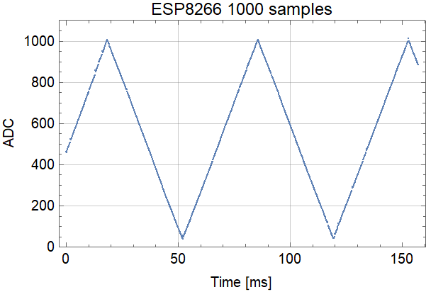

Post by sibir » Thu May 21, 2020 2:33 am
Here is a sawtooth sampled with ESP32. Note the non-linearity:
The same looks better (more linear and less noisy) on the ESP8266
But in both cases there are periodic outliers.
One could probably run slightly faster by optimizing the code. I simply used:
for i in range(1000): data.append(adc.read())
