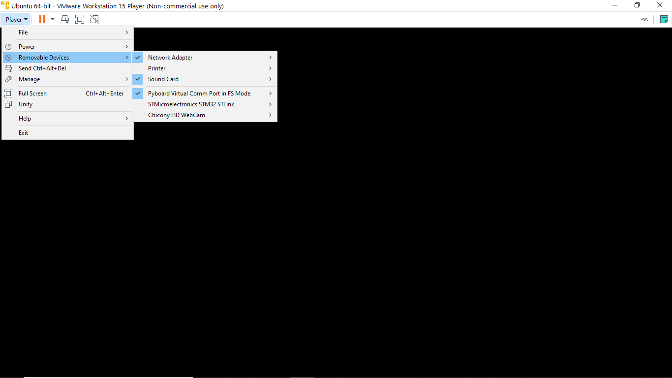

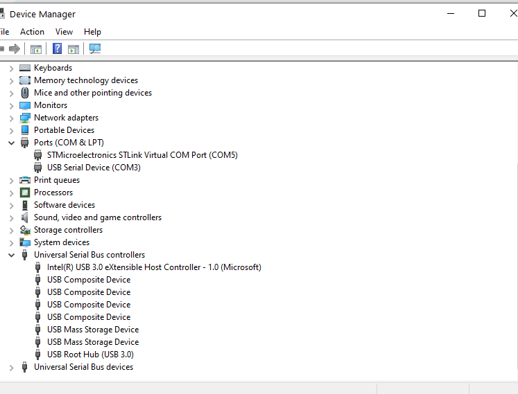

ndhuy
Posts: 32
Joined: Mon Nov 04, 2019 8:01 am
Re: Display PYFLASH of STM32L4R9IDISC in Ubuntu/Window
Post by ndhuy » Wed Dec 04, 2019 7:35 am
dhylands wrote:
Fri Nov 29, 2019 7:06 am
If you had non-micropython firmware flashed on the board before flashing micropython, then you should do a mass erase and then flash micropython.
Or factory reset the filesystem as documented here: http://docs.micropython.org/en/latest/w ... filesystem
Whwn you flash micropython, it only flashes the firmware portion of the flash and not the filesystem portion, so it's possible that whatever happens to be in the flash where the filesystem lives looks enough like a filesystem to fool micropython into using it rather than thinking its invalid and erasing it.
Hi dhylands,
my problem is quite related as I am working with STM32L4R9I-DISC. when I check in the device manager on Windows, the USB OTG FS appears as USB serial device instead of Pyboard Comm Port in FS mode (as it appears on Ubuntu). Therefore, there is no Pyflash disk appears.
And also, the connection between the board and my laptop is unstable.
Are there any problems related to USB config? what should I do to config the USB to be appear as Pyboard Port?

Posts: 363
Post by shaoziyang » Wed Dec 04, 2019 8:16 am
Delete ST device in device manager first, then search new device. ST drive may conflict with pyboard drive.
