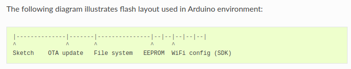

Is there a overview about the memory layout of ESP8266?
It would be cool to have something like the following for e.g. the HexViewer: viewtopic.php?f=16&t=7467 But with real addresses:
Screenshot_2020-01-04 Filesystem — ESP8266 Arduino Core 2 6 3-18-gde30762 documentation.png
Screenshot_2020-01-04 Filesystem — ESP8266 Arduino Core 2 6 3-18-gde30762 documentation.png (9.81 KiB) Viewed 5175 times
This is from: https://arduino-esp8266.readthedocs.io/ ... ash-layout

Are theses information available on the device, too?
FlashBdev / bdev instance contains some informations about flash start sector, sector size... and there is esp.flash_size() and esp.flash_user_start()
Maybe it's possible to puzzle all these information together and create a "memory layout table" ?
