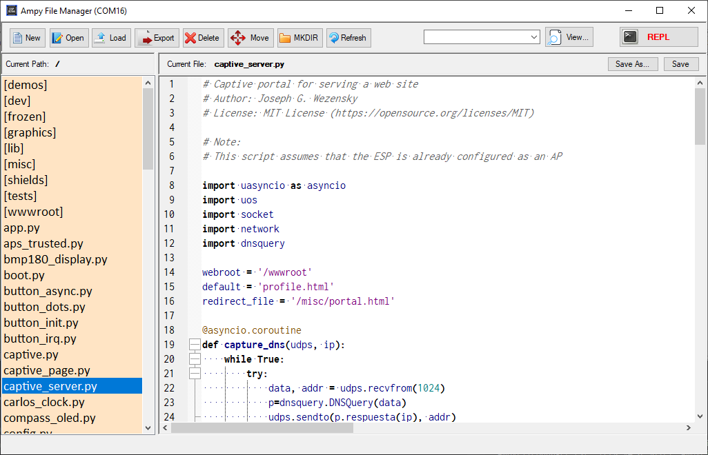

All of this discussion on IDEs has inspired me to work on some improvement for the tool I use.
https://github.com/joewez/AmpyFileManager
It's an editor wrapped around the ampy utility with a few extra features to make life easier. :D .

Post by pmulvey » Wed Apr 15, 2020 3:00 pm
I downloaded the zipped binary but it will not connect to my ESP8266. Refresh seems to be doing something but nothing appears. I edited the xml file to launch my TeraTerm:
      <add key="TerminalApp" value="C:\Program Files (x86)\TeraTerm\ttermpro.exe"/>
      <add key="TerminalAppArgs" value="-serial COM4"/>
I just get Invalid Host from TeraTerm.
