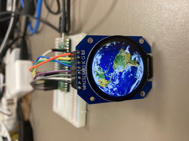

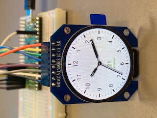

I'm working on a driver for the GC9A01 display. The driver is working with this display on a Raspberry Pi PICO. After a little more testing I'll try it with the ESP32. I should have something up on GitHub this weekend.

Post by pythoncoder » Fri Apr 23, 2021 5:55 am
I love that watch display with all its detail - even shadows under the hands. I know just how much work it takes to produce a display as pretty as that.

Post by russ_h » Fri Apr 23, 2021 2:57 pm
Pictures don’t do it justice, it looks even better in person.
