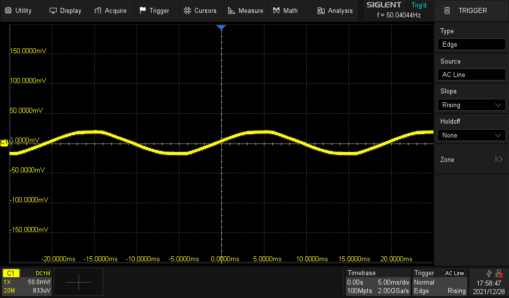

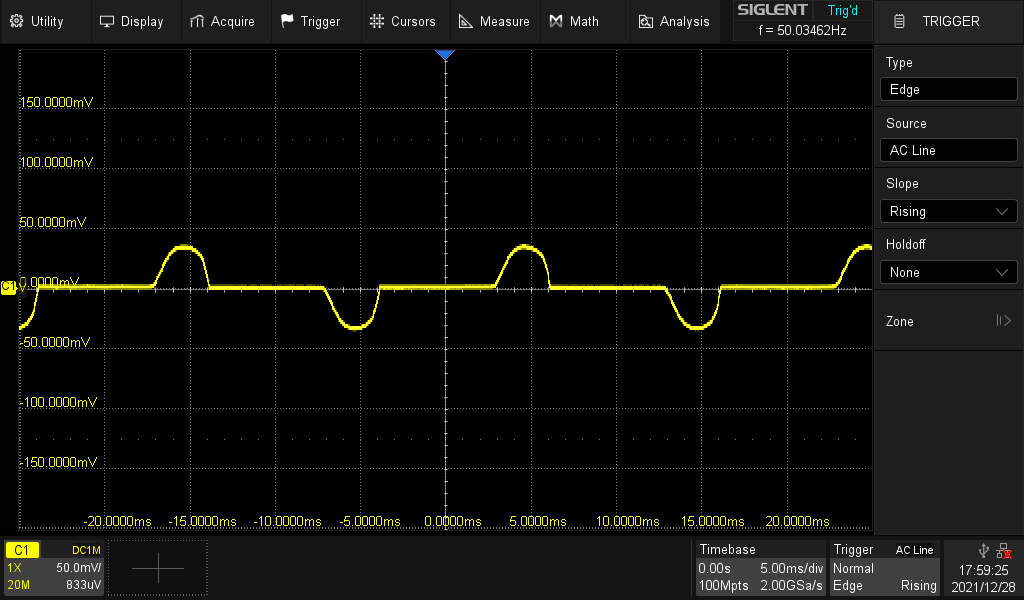

I have attached a current sensing transformer like the one in the ZMCT103C to a LED load and a resistor load an captured the output signal with the oscilloscope. You can see that the LED takes a current only for a short time during the input wave. That could show up in your pictures as well.
LED Load, average AC current 30mA
Resistor load, Average AC current 30mA
