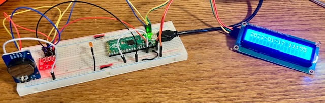

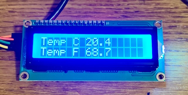

I'm developing a project using micropython on a Raspberry Pi Pico with an RTC clock, temp sensor, and displaying on a 1602 LCD. It's working thanks libraries and tutorials written and shared by others like David Hyland. Thank you!
I'm stuck trying to convert then compare the bytes returned from the RTC with integers. For example I would like to code:
if (minute == 30) and (second == 0):
    do_something()
I can't figure out how to cast or convert the bytes returned from the RTC, so right now I have a simple counter in an "if" statement. My code and some photos follow.
Thanks for any help.
Jake
