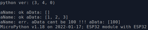

I found a bug in constructor with default value.
In last line aData should be [], but not a 100.
This problem also occures on Linux, Windows.
import sys
class TClass1():
    def __init__(self, aName: str, aData: list = []):
        print('aName:', aName, 'aData:', aData)
        self.Data = aData
print()
print('python ver:', sys.version_info)
print()
c1 = TClass1('ok')
c1.Data.append(100)
c2 = TClass1('ok', [1,2,3])
c3 = TClass1('err. aData cant be 100 !!!')
----- result ---:
python ver: (3, 4, 0)
aName: ok aData: []
aName: ok aData: [1, 2, 3]
aName: err. aData cant be 100 !!! aData: [100]
Знімок екрану_2022-04-03_14-33-24.png (12.38 KiB) Viewed 3478 times

The 'problem' even exists on my ordinary python:
Python 3.10.2 (/usr/bin/python)
>>> %Run test_class1.py
python ver: sys.version_info(major=3, minor=10, micro=2, releaselevel='final', serial=0)
aName: ok aData: []
My interpretation: By
self.Data = aData
you introduce a reference to an object (aData), which continues to exist while the scope of aData is lost. aData was an argument and thus has only meaning within the function body ( __init()__ ).
Using
self.Data = aData.copy()
the problem is gone.
