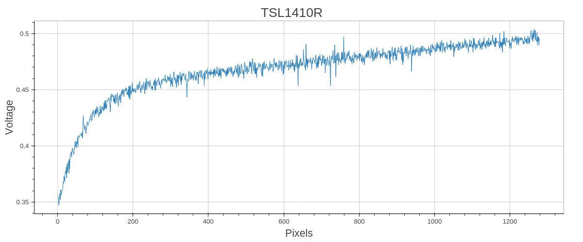

A good thing is that the generated data reflects the level of the light the sensor was expose to. I just don't know if the code generates the correct data. Please take a look at the attached picture(the sensor was under semi-dark environment). I would highly appreciate if you can share your opinion about correctness of the code.

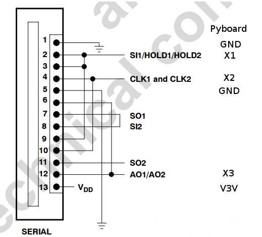

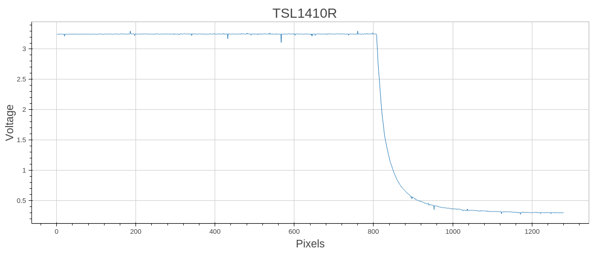

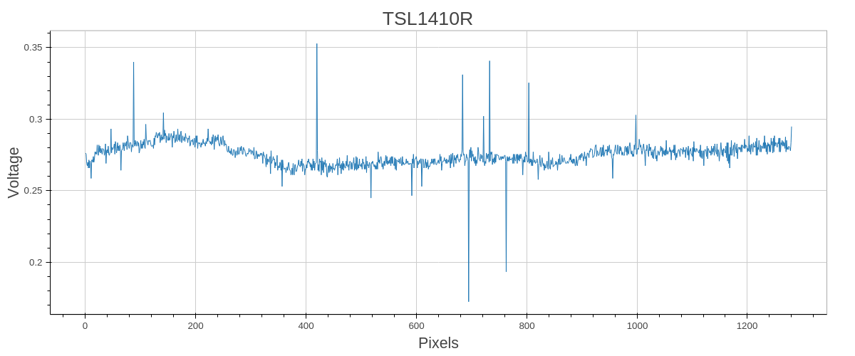

Thank you very much for examining and correcting my code and providing a clear explanation of my mistakes. Data, gathered by the updated code, you can see in the attached files: 1. Sensor was covered by a box. 2. A half-covered sensor. The shape of the line (covered sensor) this time is a little different from what I got using my code(see the picture posted yesterday). Just in case, here is my wiring diagram, maybe the wiring is incorrect.

Vitali - looks like you have it working! Those plots are pretty much what i would expect to see given the set up that you described. The saturation seen in the pixels up to ~810 isn't surprising, the next thing you probably want to do would be to establish more precise control over the integration time. There are several threads here on the forum about tricks to achieve more precise timing when bit-banging GPIO pins.

@Chemist That schematic is identical to that shown on the device datasheet so we can assume it's correct. I'd agree with @blmorris and say that's working. With point source illumination you might get a sharper edge on your graph. As for more precise timing, from my reading of the datasheet the device is uncritical in that respect. It is entirely synchronous.
