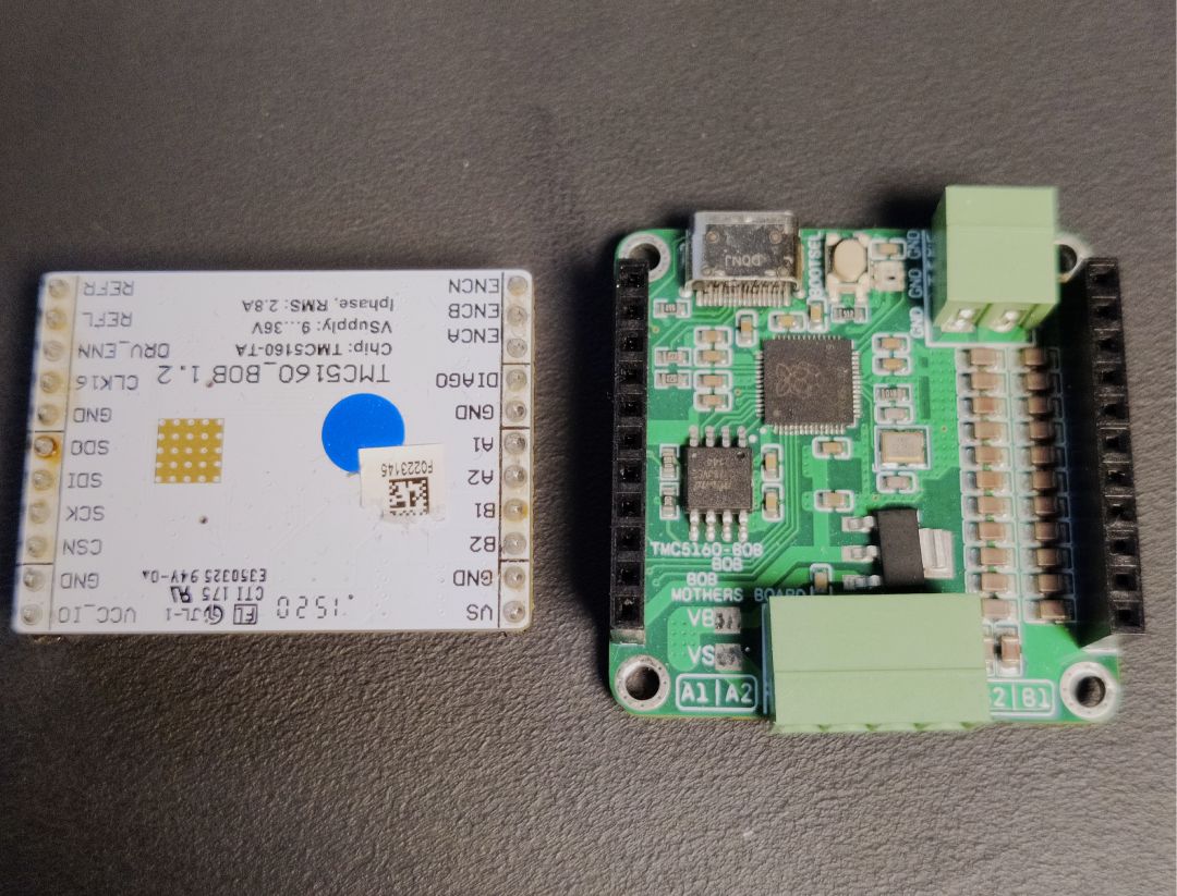

Let me explain. This is my BOB BOB BOBS MOTHER BOARD. Its a RP2040 board for holding a Trinamic TMC5160 BOB(break out board).
I can control the TMC5160 board via the micropython repl. But i want to control it from some python3 code i run on my desktop. With pyserial or whatever. My desktop can be apple, win, ubuntu.
