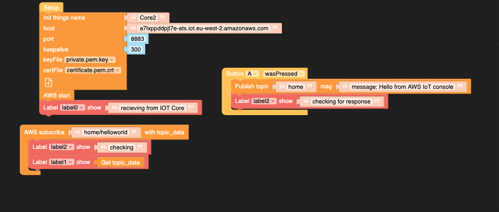

Post by AJB2K3 » Thu Apr 15, 2021 5:39 pm
Screenshot 2021-03-20 at 12.28.45.png (84.62 KiB) Viewed 12087 times

On the M5Stack?
