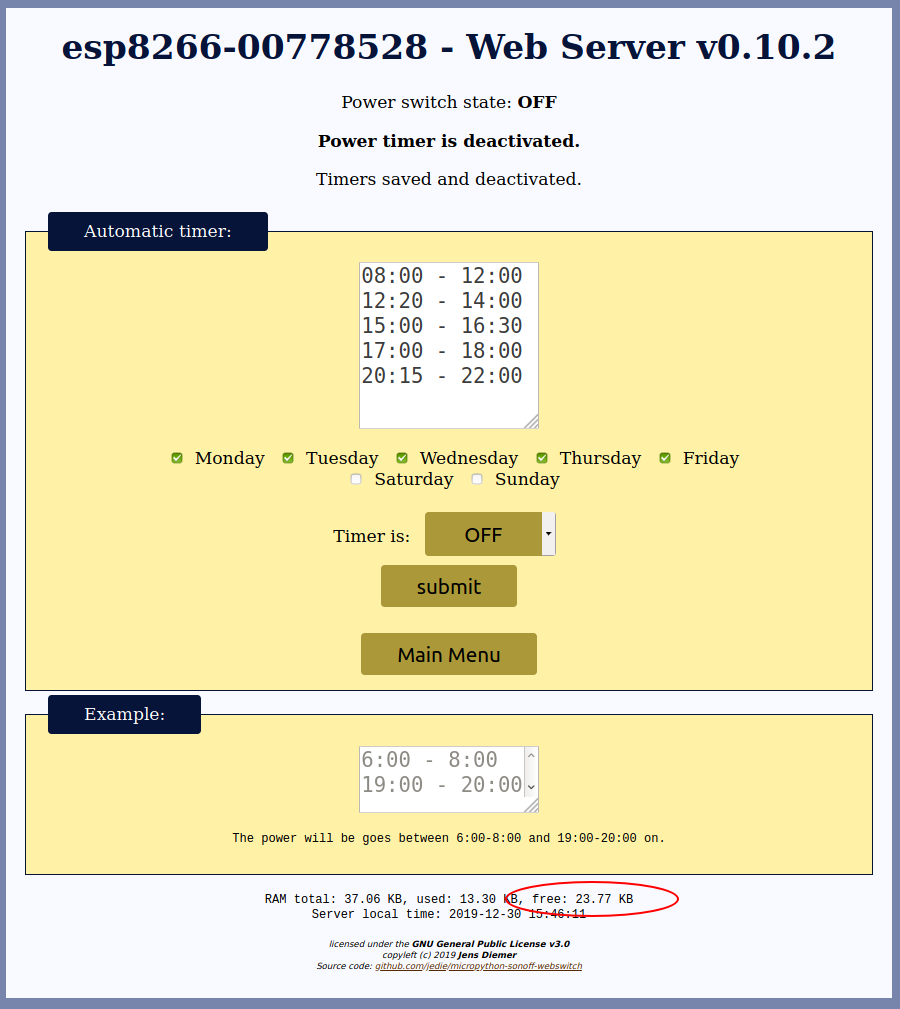

Post by jedie » Mon Dec 30, 2019 2:54 pm
I have build my first firmware... and wow... i get many free RAM:
