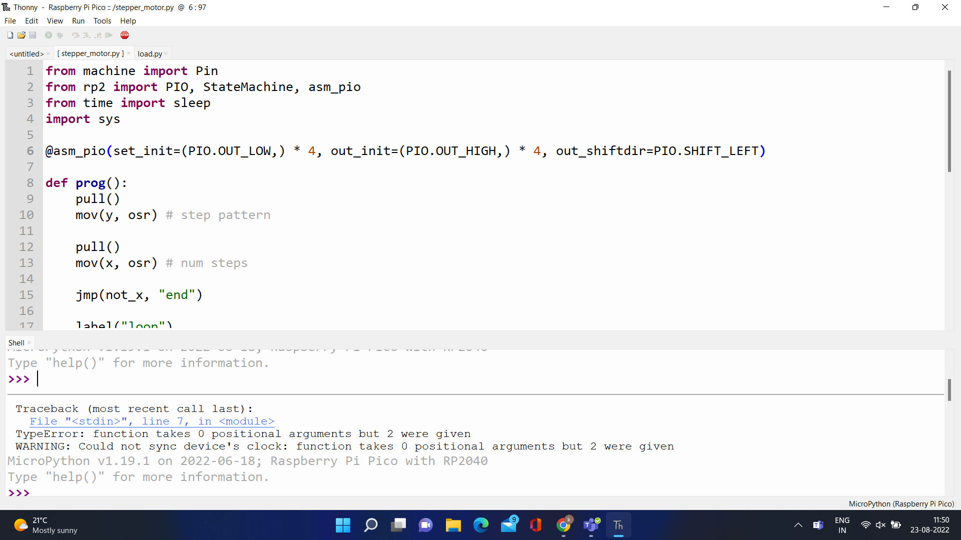

Post by likith1268 » Tue Aug 23, 2022 10:51 am
hello there,
I have two Raspberry Pi Picos, both are giving me the same error without even running the code.
File "<stdin>", line 7, in <module>
TypeError: function takes 0 positional arguments but 2 were given
WARNING: Could not sync device's clock: function takes 0 positional arguments but 2 were given
I'm attaching the screenshot of the error below.
can anyone help me with that??
Screenshot (114).png (204.41 KiB) Viewed 6516 times

Post by jimmo » Tue Aug 23, 2022 2:20 pm
Thonny is trying to inject some code to set the RTC, but that is failing. The injected code does
from machine import RTC as __thonny_RTC
__thonny_RTC().datetime({datetime_ts})
I'm not sure why this is failing and saying that datetime() takes no arguments. Since the Pico port for MicroPython was first released, it has always taken a tuple (plus self, which makes two).
I think you'll need to follow this up with Thonny - see https://github.com/thonny/thonny/issues
