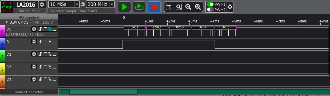

So I have a first implementation for RP2040. Some pictures below. The test script is:
from machine import UART, Pin
u=UART(0, 9600)
p2=Pin(2, Pin.OUT, value=0)
def run(n=1, t=9999):
    p2(1)
    u.write("abcde"*n)
    print(u.flush(t))
    p2(0)
The code is at: https://github.com/robert-hh/micropytho ... uart_flush
Timing Diagrams:
5 byte message
10 byte message
Note that for the short message flush() returns while the last byte is still sent. short means: length <= 5, for whatever reason.
