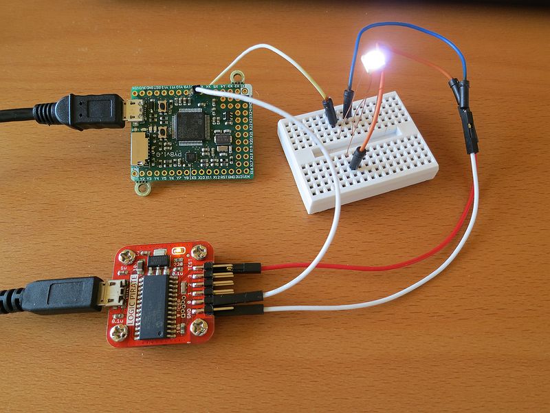

here is some MicroPython code which drives a WS2812 LED:
# MicroPython example for controlling one WS2812 LED.
# Method similar to http://www.espruino.com/WS2811
from pyb import SPI
spi = SPI(1, SPI.MASTER, baudrate=6400000, polarity=0, phase=1)
spi.send(chr(0x00))
def byte2bits(byte):
    b0 = chr(0x03)
    b1 = chr(0x0F)
    bits = ''
    mask = 0x80
    while mask != 0:
        bits += b0 if ( byte & mask ) == 0 else b1
        mask >>= 1
    return bits
def sendColor(red, green, blue):
    spi.send(byte2bits(green)+byte2bits(red)+byte2bits(blue))
import math
n = 0
    r = int((1 + math.sin(n * 0.1324)) * 127)
    g = int((1 + math.sin(n * 0.1654)) * 127)
    b = int((1 + math.sin(n * 0.1)) * 127)
    sendColor(r, g, b)
    n += 1
    pyb.delay(20)
Have fun,
Markus

The PCBs finally arrived and driving 10 LEDs works with an acceptable frame-rate: http://youtu.be/GHmoE9ui4NU
Driving over hundred LEDs might be difficult with my approach, since it will get quite slow, and I am not sure if there is enough memory to hold the data string without any optimization.
Here is the updated code:
