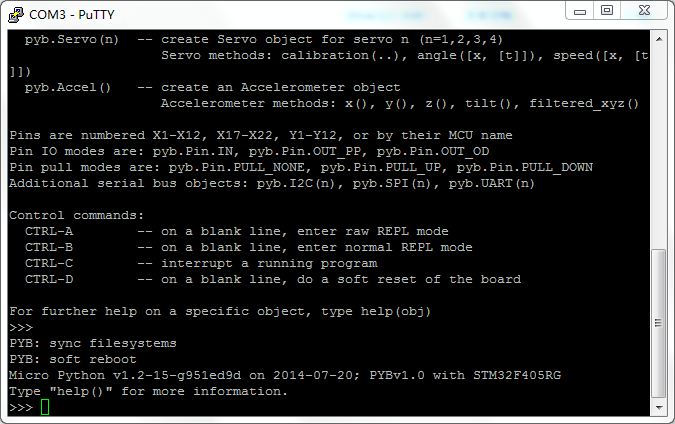

Hi, dhylands
Thanks for the timely feedback.
See the attached picture for what I got. There is no USB_VCP within pyb and sys modules.
I might flash the wrong version of mircopython. Then how could I read out mircopython version running on my chip?

Hi dhylands,
I just commented out all codes in main.py. I saw the first prompt containing the micropython version info. as captured in the attached picture.
It is version 1.2-15-g951ed9d on 2014-07-20.
At least in this version, the USB_VCP does not exist.
It also seems I might have flashed the wrong file two days agao.
2014-09-14 11_44_20-COM3 - PuTTY.png (34.25 KiB) Viewed 13539 times

Hi, dhylands
I just tried the latest version. It works. Thanks for the help.
