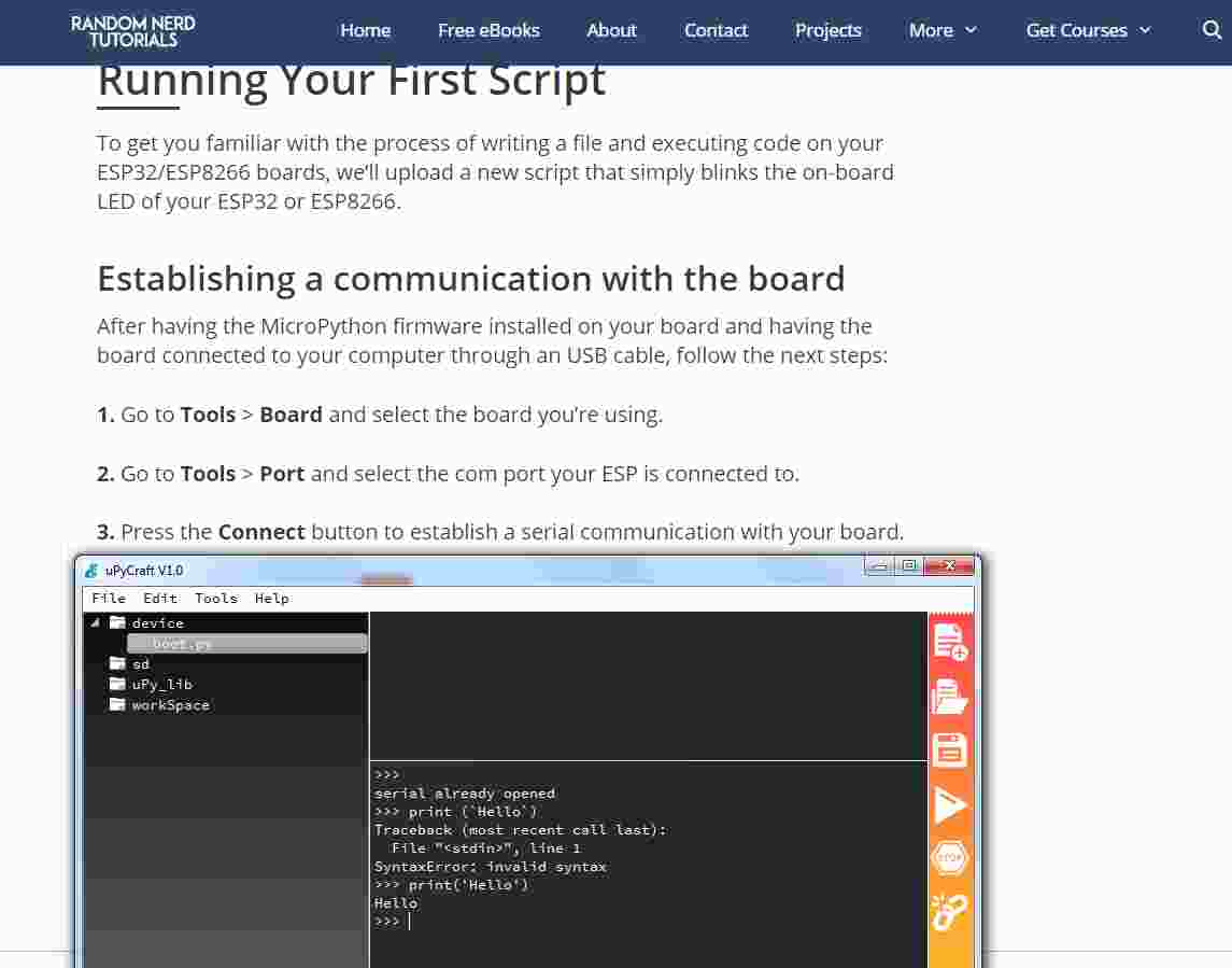

hello and good day
many thanks for the quick reply _ after having tried some thing - the biest just started to work .
serial allready opened ... and i guess that i have managed to connect to the board and to work on it.
btw: i have in the device folder
device/
boot.py
but no main folder (guess that this will be loaded with my first script)
see the attached image to see that all is woriking now at least regarding this tutorial
https://randomnerdtutorials.com/flash-u ... 2-esp8266/
