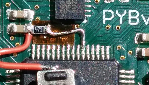

I had the same problem with another STM32F4-based board. Turned out that there was no pull-up resistor on SDIO_CMD line. On the prototype I've solved it by enabling internal pull-up on that CPU line and then added external resistor on next hardware revision.

dilogic, are you sure you had the same problem, maybe you had similar one? As you have experience with that matter, it would be nice if you could review PyBoard design - it's open source - and provide your recommendations. Thanks.

I took a look at the schematic, and there is no pullup on the SDIO_CMD. So I'll add one and retest and see if it makes any difference.

it was not the same problem technically, as the board I've experienced it with was not pyboard, but the behaviour was exactly the same as well as the CPU, so my guess is that the solution can be the same (10K pull-up on SDIO_CMD). Also, the problem occured only with high-speed type cards.

I added a 47k pullup on the SDIO_CMD line (aka PD2), but it didn't change the behaviour - cards that worked before still work, and the cards that failed before still fail.
I also verified that the sdcard_init routine enables the internal pullup as well:
https://github.com/micropython/micropyt ... card.c#L59
I attached a photo of my mod (and checked under the microscope that there are no shorts to adjacent pins, nor the via that is close to the bend).
