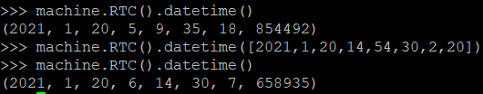

Upon setting the datetime with machine.RTC().datetime(), the hours, minutes, and day of the week appear to be reading incorrect values:
Does anyone know why this happens?

It looks like the arguments to datetime are expected to be in the following order:
(year, month, day, weekday, hour, minute, second, subseconds)
Got it, thanks. There appears to be a discrepancy between utime.localtime() and machine.RTC().datetime() then:

There is. utime.localtime matches CPython's time module. Unfortunately RTC.datetime() - which isn't even documented - adopts a different convention which is based on STM hardware and the pyb module. The nearest you'll get to docs may be found here.
