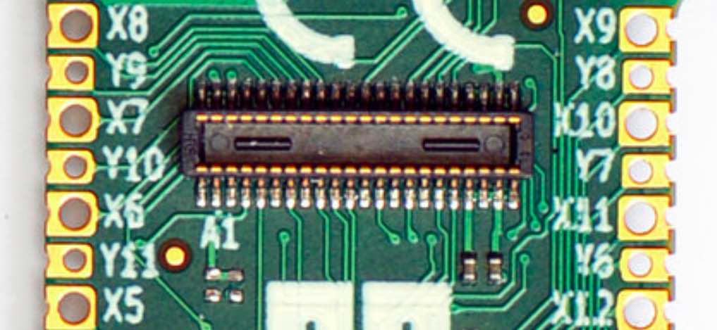

Why do you call it a "40pin" connector when every pyboard-D picture I look at (e.g. this one:
which is a zoomed in version of a picture taken from https://store.micropython.org/product/PYBD-SF2-W4F2 ) appears to show both 44 pads and 44 gold contacts inside the connector. I say this having noted that there are lots of connector types in the DF40 series which include both 40 and 44 pin options. See for example page 1 of this datasheet. So I am prepared to believe that it *is* a 40-connector connector.
Even the micropython store calls these "Physical electrical connectivity via 24 through holes, and a 40+40 pin mezzanine bus connectors" on https://store.micropython.org/product/PYBD-SF2-W4F2 , but overall I'm clearly misunderstanding something somewhere, because it looks more like 44 to me.
NB: I am aware that some DF40 connectors come with four extra pads for mechanical security. But I think those are slightly separate from the rest which the ones in the above picture are not.
I'm going to get my next board design all wrong unless I can figure out what's happening here.
tve
Posts: 216
Joined: Wed Jan 01, 2020 10:12 pm
Location: Santa Barbara, CA
Re: PYBD WBUS connector
Post by tve » Fri May 08, 2020 2:14 am
Hmmm, intriguing indeed!
The picture on the digikey page clearly has 40 contacts.
The PYBD schematic clearly has 44 contacts.
If it looks like a 44 pin connector, walks like a 44 pin connector, smokes like a 44 pin connector, it must be a ?
