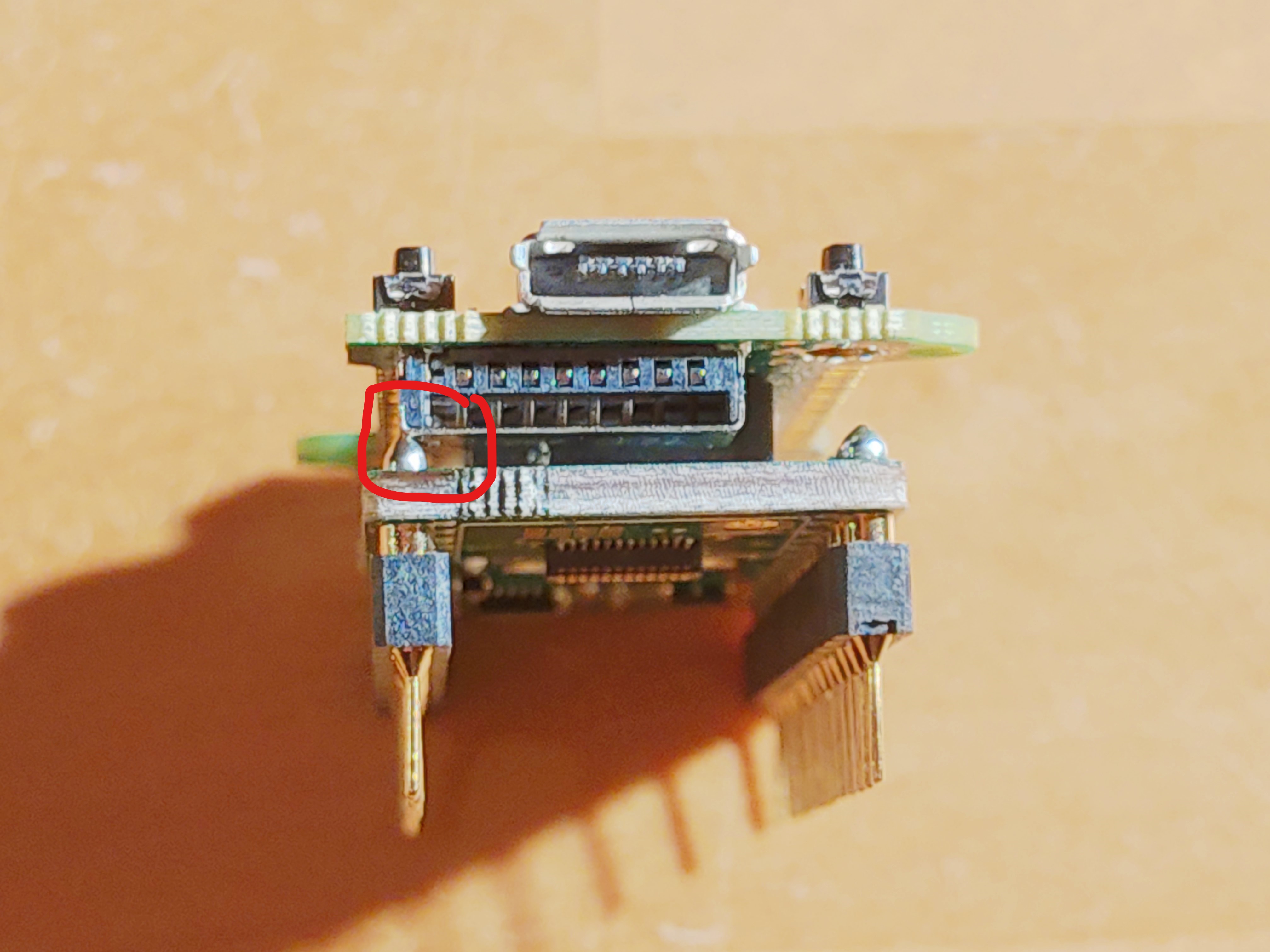

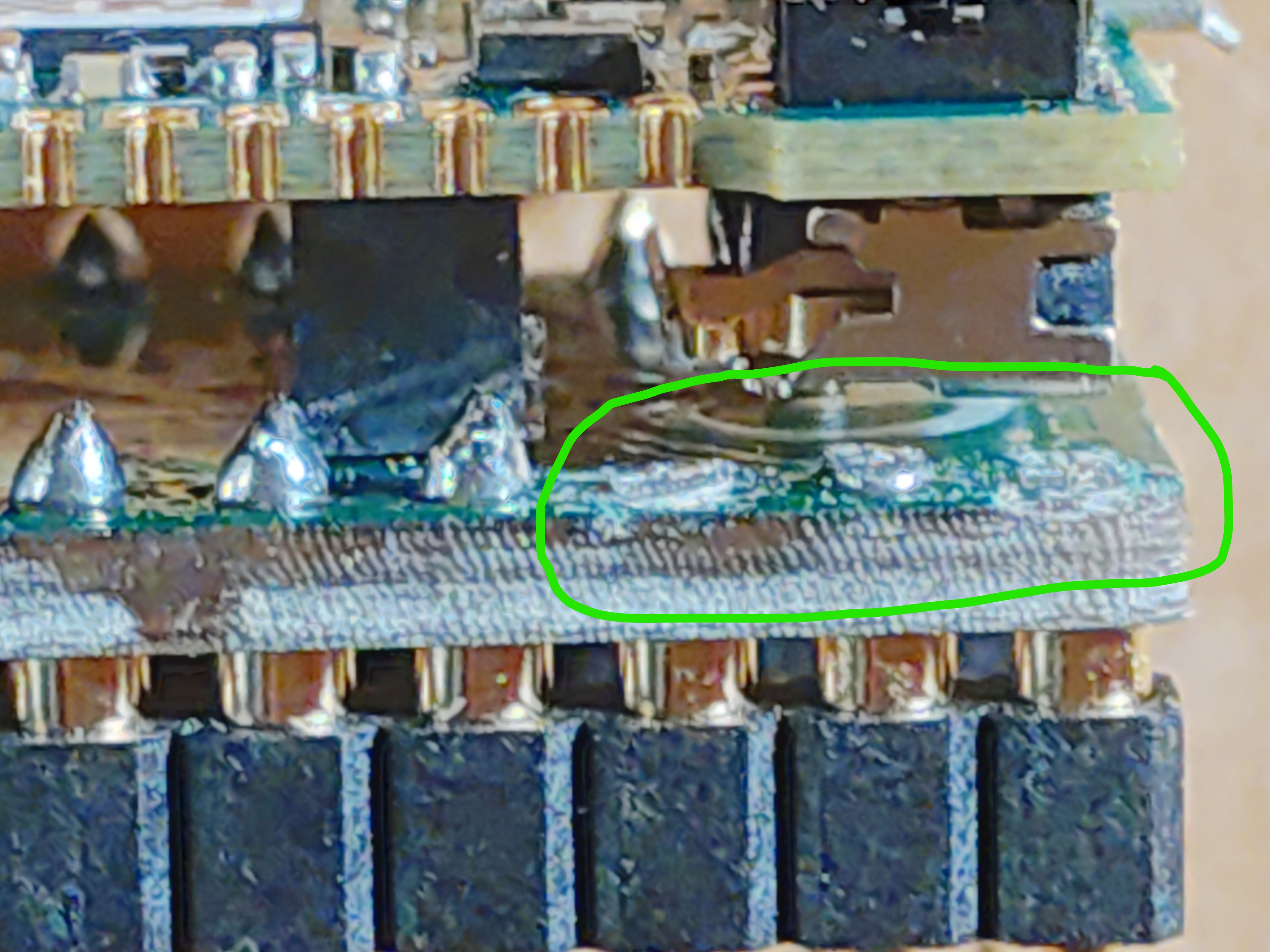

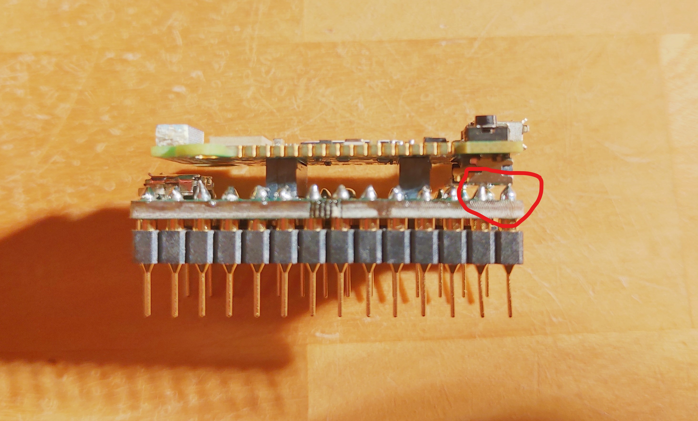

I also noted that I ran into a hardware design issue due to the placement of the SD-card reader, when mounting it to the WBUS-DIP28 if the latter has strip connector pins soldered. In that case the VIN and 3V3 pins of the WBUS-DIP28 easily touch the SD-Card reader outer metal, causing the PybD not to work (and I got a report form my PC that a USB-port was drawing excess current, indicating some short-circuit issue ...). The two pictures below show the issue:
This however can be easily solved by wirecutting away the top part of those pins (and the GND pin near to it), as shown here:

Yup, my DIP28 looks exactly the same

There are shorter male headers so that they don't touch the Pyboard D.
Anyway, it would be better to have a note about this issue in :
https://pybd.io/hw/wbus_dip28.html
