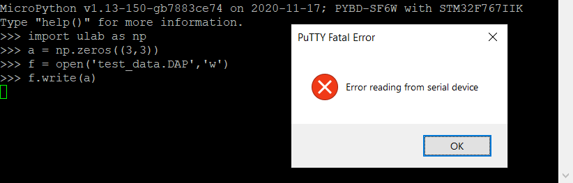

Hi, I am trying to store data on the SD card on my PYBD-SF6W. I am running Micropython v1.13-150-gb7883ce74. I am able to write strings to '.txt' files no problem. I can also write dictionaries that contain numpy arrays to '.json' files without any issues. However, when I try to write numpy arrays directly to '.txt' or '.DAP' files, I receive fatal errors:
.txt error.PNG (15.17 KiB) Viewed 7426 times
.DAP error.PNG (15.15 KiB) Viewed 7426 times
Does anyone have an idea as to why this might be happening? I did not have this issue on Micropython v1.12.
Re: Unable to write numpy arrays to '.txt' or '.DAP' files on SD
Post by jimmo » Mon Jan 11, 2021 1:04 am
kbrenner wrote:
Sun Jan 10, 2021 8:52 pm
My understanding is that f.write(data) should attempt to call mp_get_buffer_raise on the ulab array type.
To isolate the problem, can you try doing
import ulab as np
data = np.zeros((3,3))
buf = bytes(data)
print(buf)
That will at least check whether there's something going wrong with file i/o or with ulab's implementation of mp_get_buffer_raise.

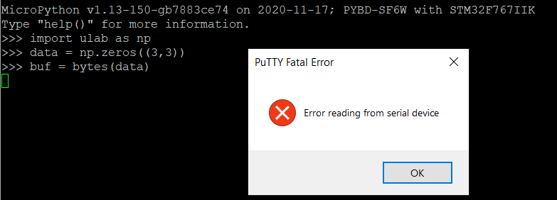

Upon trying to that code, after typing buf = bytes(data), it stalled and then errored, and I wasn't even able to type print(buf):
buf error.PNG (13.18 KiB) Viewed 7410 times
Post by jimmo » Mon Jan 11, 2021 2:58 am
kbrenner wrote:
Mon Jan 11, 2021 1:56 am
I think this might be worth raising at https://github.com/v923z/micropython-ulab
