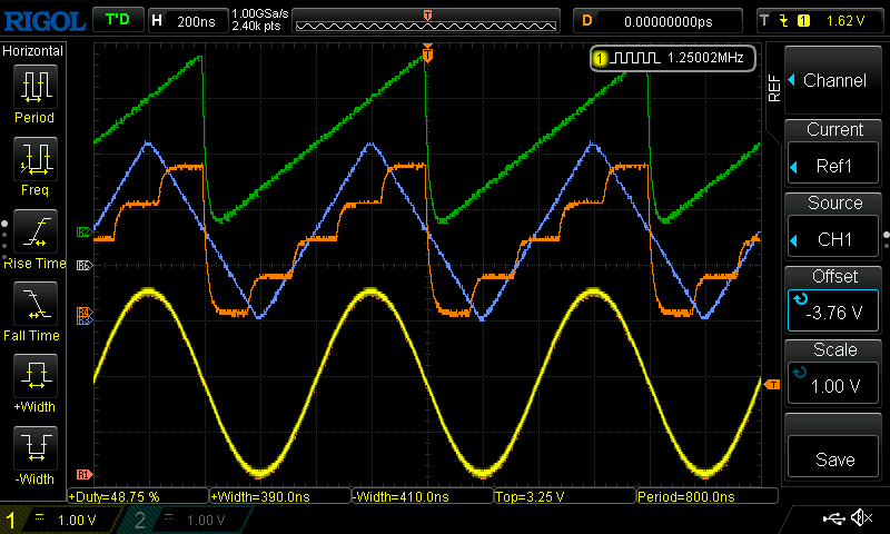

OK it works, it is amazing: true 125Msps AWG without even overclocking, and without CPU!!
Trick was to use a second DMA channel to reconfigure with a single write to the READ register the first.
The DMA sends 32-bit words but the PIO only consumes 8 bits a time, so there is no delay in the reconfiguration.
I soldered an 8-bit R2R DAC to GPIO pins 0-7 and get very neat sine, triangle, saw-tooth and ladder shapes. Each wave consists of 100 samples, and the resulting output is exactly 1.25MHz. Parasitic capacitance or inductance with a characteristic time of ~20ns deform sharp edges a bit, but overall analog bandwidth appears to be at least 20MHz if not more. I have no idea how to make a decent front-end for this, my previous Arduino-based AWG had 381ksps and could be buffered and amplified by a sluggish LM358 opamp.
The code is still a mess but it's a proof of principle, next step would be a nice interface for 20+ shapes, amplitude control, sweeping etc

- Screenshot 2021-02-07 at 19.19.15.jpg (91.43 KiB) Viewed 19424 times
- DS1Z_QuickPrint14.png (51.78 KiB) Viewed 19430 times
