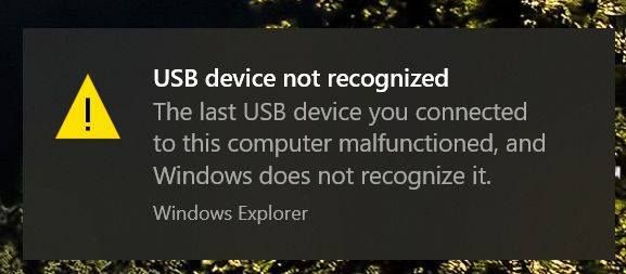

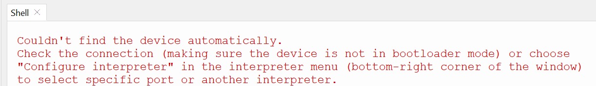

As you can see, there is nothing special about this code, but when I save this on my Pi Pico as main.py, it runs as it is supposed to, but...
if I unplug the pico and replug it in Windows shows this message: "USB device not recognized"
windows not recognizing pico.jpg (22.9 KiB) Viewed 10085 times
Thonny message.jpg (54.28 KiB) Viewed 10085 times
Device manager shows a device with the warning yellow triangle. Scanning devices, replugging the pico does not change the status.
Restarting the PC DOES fix it - Windows recognize the Pico again, and I was able to use Thonny to fix main.py so this no longer happen.
Interestingly, my Mac does NOT have this issue. Same Pico, same untouched main.py.
I suspect it has something to do with I2C being too busy to handle USB traffic.
Have you seen this behavior on your Pi Pico?

Thanks hwiguna
I hade the same problem, restarting the PC, Win 10, solved it.
russ_h
Posts: 88
Joined: Thu Oct 03, 2019 2:26 am
Re: Windows fail to recognize Pi Pico when running this code
Post by russ_h » Fri May 07, 2021 3:17 pm
I’ve seen this issue on Windows 10, a reboot seems to clear the problem for a while. I have not seen the problem while using a Mac or Linux.
Jackli
Posts: 80
Joined: Thu Apr 29, 2021 9:11 am
Post by Jackli » Tue May 25, 2021 3:33 am
Yes, I am Win10, I also restarted my computer to solve the problem.
