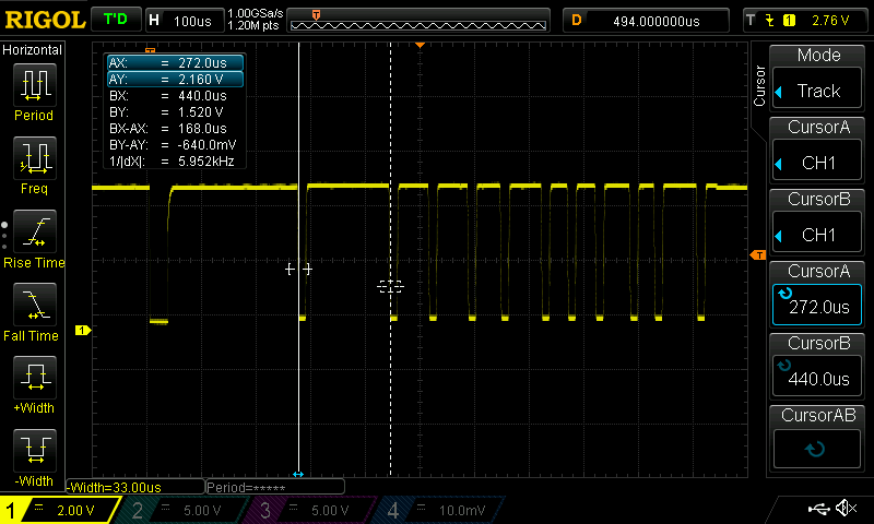

Maybe I should explain what I would like to do. I have a sensor with SPC interface (for an explaination see https://www.nxp.com/docs/en/application-note/AN4219.pdf) where the time between falling edges of the signal line defines the data transferred.
This is a screenshot of the Master trigger pulse with 33us low time (measurement of channel 1) and the synchronization pulse starting 272us after the start of the trigger pulse ending at 440us. So the unit time of this sensor is 3us.
In order to decode the sensor output, I need the times of the falling edges. This with the unit time gives the data nibbles.
Of course I could do it with one of the Cortex-M0+ cores, but I think this is also possible with PIO "in the background".
My concept would be the following:
The register X is set to a predefined value with the trigger pulse and then decremented. At each falling edge the register value is then pulled into the RX-FIFO. At the end from the deltas of the time of the falling edges the data nibbles can be computed with the help of the length of the synchronization pulse.
